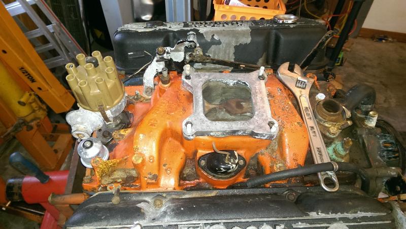

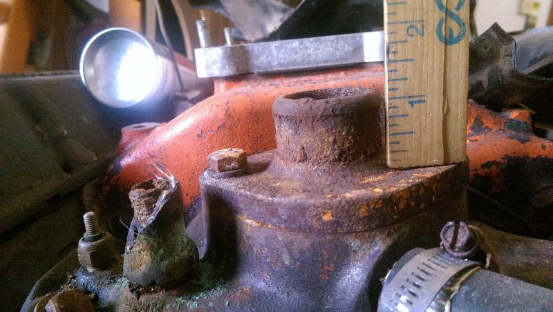

Hard to see but here's what I got. You can gauge the hight with the clamp laying on it .
Yes, that's what mine looks like alright. Thank you. One more question, my alternator lines up perfectly with the crankshaft pulley, but the P/S is a little off and I cannot figure out the reason. Is this common to this year/model?

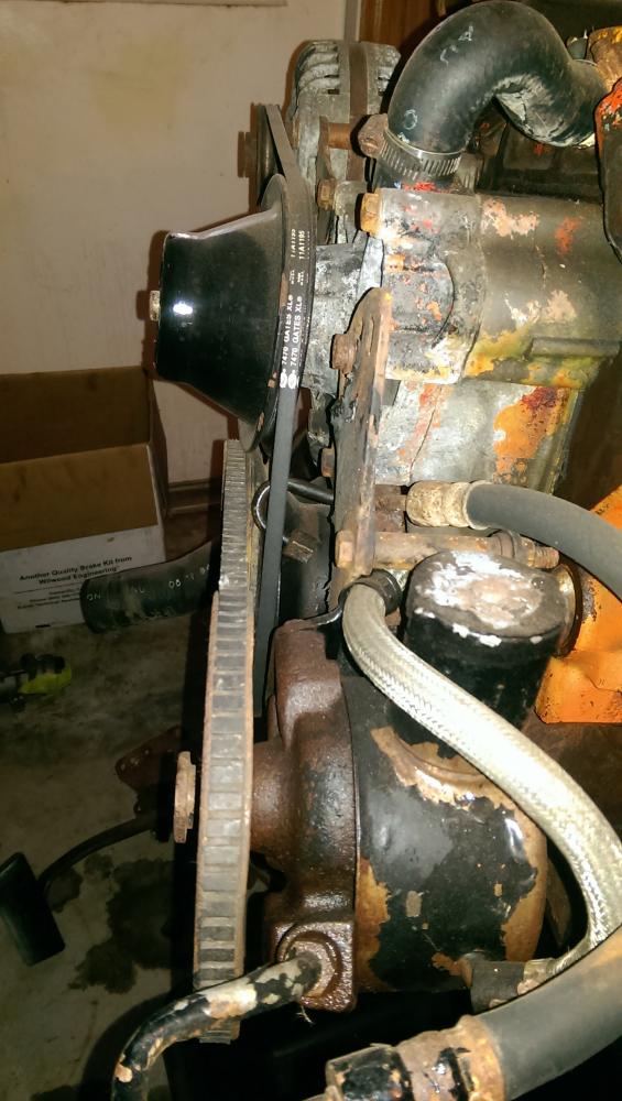

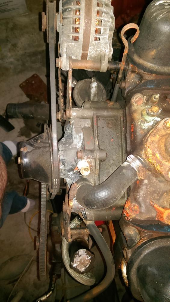

Sorry about how long the site wouldn't let me post for some reason so I figured I'd try later. Here's the pics (no spacers) there's no bolts in water pump pulley that's why it's crooked
To me the P/S pulleys look in the photos to be just a little off from a perfect match, but not enough to bother trying to make any efforts to improve the alignment. My are a little worse, but no belt noise or belt throwing going on either.

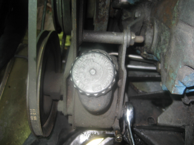

On my 72 Coronet 318 The powersteering pump is a little off to. Haven't had any problems
