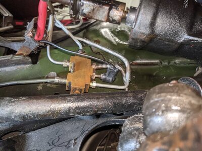

Thanks for the help, I had to dig this thread up. So now I got the light on the dash to go out by pulling the pin out and putting the wire on the end of the pin. The pin really seems loose and wobbling around in the valve. There is a nut on the pin and I really don't know what it is for? Maybe a jam nut for the wire? Until I pulled the pin all the way out of the block the light (on the dash) would go off and on in general and as the car would hit bumps etc.. Now as I drive the car some I am starting to realize it seems to be stopping with the rear brakes mostly.. So is that part of this puzzle??

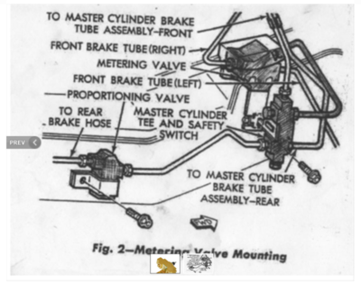

So you can see that my car is not plumbed as the picture. Its a disk brake car and I have the valve in the line going to the rear brakes but I don't have the metering block for the front brakes? So what is going on here? Thanks Jay

Not all B bodies had them. I believe they were installed, when the single piston calipers came out in 1970. They held off application of the discs until the rear drums started to engage, which was beneficial in slippery conditions.
