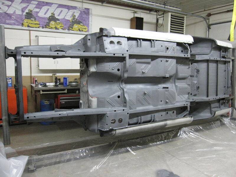

Man, that must have taken a bazillion man-hours!
I think it took me 6 hours but there wasn't a speck of rust under any of it. In some cases once you were able to get under the edge of it it would peel off in sheets.

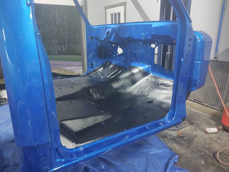

Ok so bed liner was used on the a lot of my car. Inner frame rails and where ever I could stick the bed liner gun with the extension wand. 360 degree tip. Used Rust Oleum. If you read the make up of Raptor and other liner's they all have the same make up. Just paying for the advertising. It an epoxy base and it sticks well. Have it it and it don't come off. Put it in the fender well's also. Did my cut off at the fire wall. Did all the quarters with it before welding on and the roof also. In side. Floor pan's-fire wall. Shot it inside the door's. All inner frame rails. First I sprayed epoxy on every thing then the bed liner. Had to thin it down to spray in the gun and two coat's so by thinning it down the sand settled to the bottom of the gun and did not make such a rough texture. But no it is not smooth. The CA. guys have been using it for year's they strain the sand out of it. To tell the truth My car would not be here if it where not for the under coating they put on it at the factory. So each to his own and mine is a driver and not a show car where I will put down mirrors to see the bottom but it look's clean under it. You can see it on the tunnel and fire wall. I do suggest to get the extension wand and spray gun from east wood the other wand just spray's out the end and both worked well held the gun and held the wand and could get and even coat also easy to move the spray around where I wanted it.

I used bedliner on mine, I drive it way to much to want it painted on the bottom. What I did was paint the top of the frame rails then mask it off and sprayed bedliner from there down.
