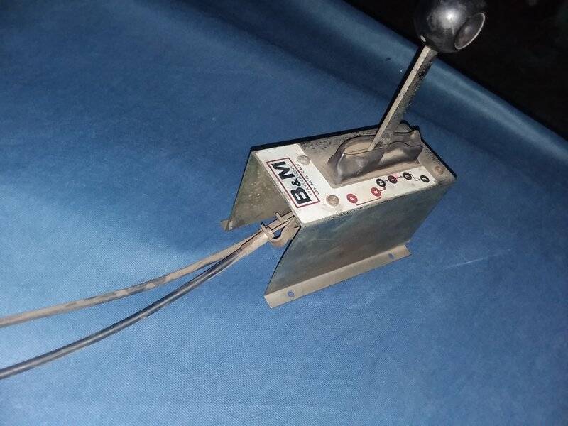

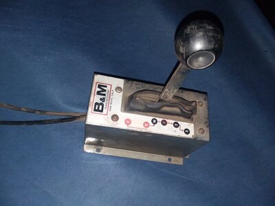

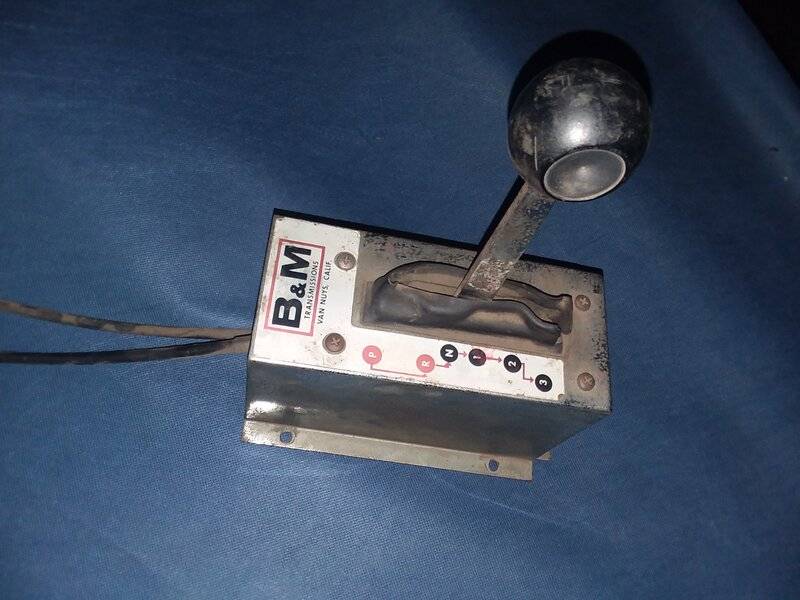

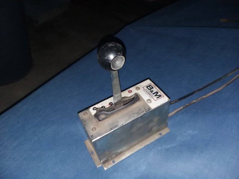

MANY years ago B&M made a chrome box shifter, specifically for pushbutton trans. You can i.d. one by the two cables. Good luck finding one. It would probably be easier to change to a later trans. I believe Hemi-itis uses a shifter tower like Mike describes.
