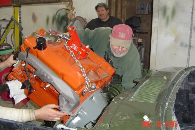

here's a bb going into a 69 SBee
above is a great example of what i am talking about. see the huge angle they need in order to fit the engine/trans in as one unit?
if you raise the rear of the vehicle you can lower that angle (or keep it) and not worry about thrashing your core support. if you have another person handy, you can have them underneath sliding the trans over the trans crossmember at the same time as installation.

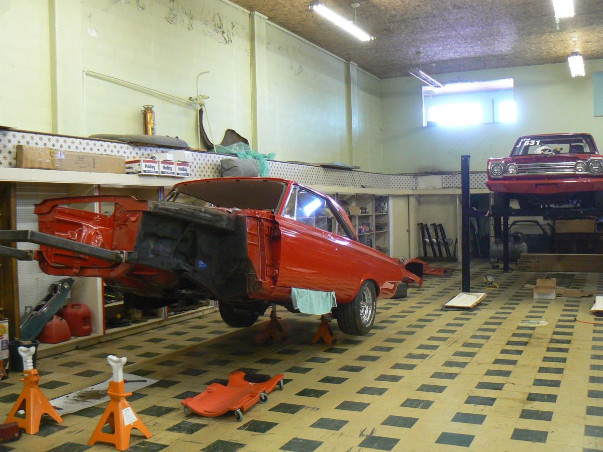

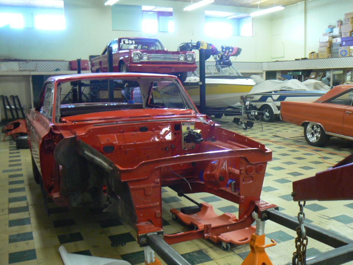

I usually unwind the torsion bars to lower the front end when I pull and install engines. I have a stationary hoist in my shop so the car needs to be able to roll once the engine/trans is up. I've used engine cranes before and I find it's easier to mess up the car with one of those than it is to use my overhead setup. Over the years, I've been a shift worker and having help show up when I needed it was usually a hassle so I just learned how to be a one man band instead of waiting on others convenience and did what I needed to do when I needed to do it. I've worked by myself for so long now that it actually slows me down when there is people trying to help lol

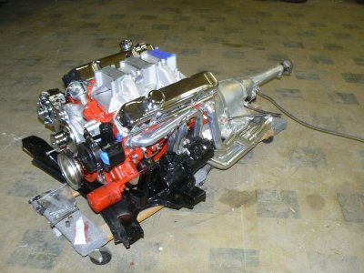

Next time I need to pull an engine, it's coming out the bottom, on the K member as a whole unit.
The 1st time takes a little more planning, but thats the only way to go for me.
