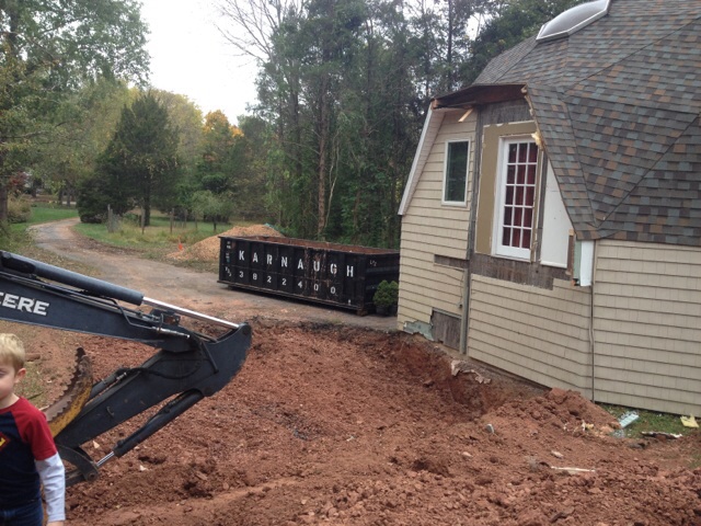

Putting an addition on the ol' dome home.
You need to add a nipple to the roof to give it the look of the" Booby Trap".
i was thinking about shaping the addition like a sandwedge and painting the dome white. :)
Nice have fun filling the new shop !! Only took me 5 years to fill my 26x40 shop lol! :headbang:
damn, what i would do for a 26X40 shop!! my little 16x32 is going to fill up quickly, but it's better than my current 16x19. with my 18' long car, i need to decide if i want to squeeze by the front of the car or back before i pull in lol.
That's great HT . . . exciting times as the house gets expanded ! ! ! That is going to look so cool ! ! !
You going to lose you smiley face ( the two windows are the eyes . . . )
Thanks, 67, yeah, we here at the 413 household are pretty stoked! Yep, that smiley face is gone, but we get a new one on the addition, so all is good in the world. :)

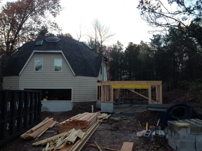

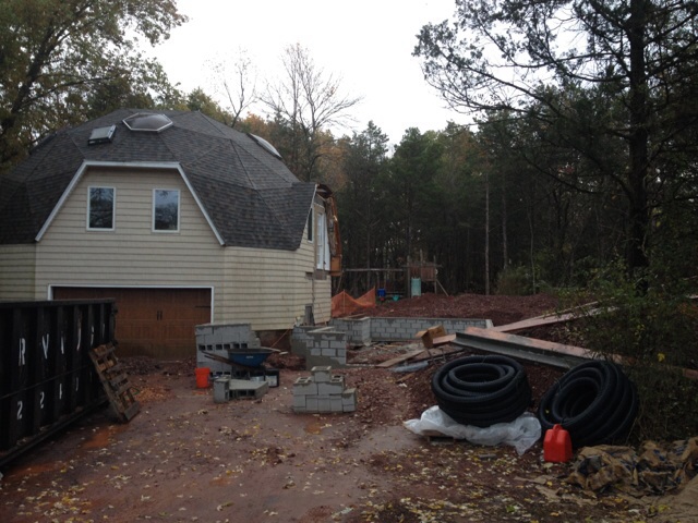

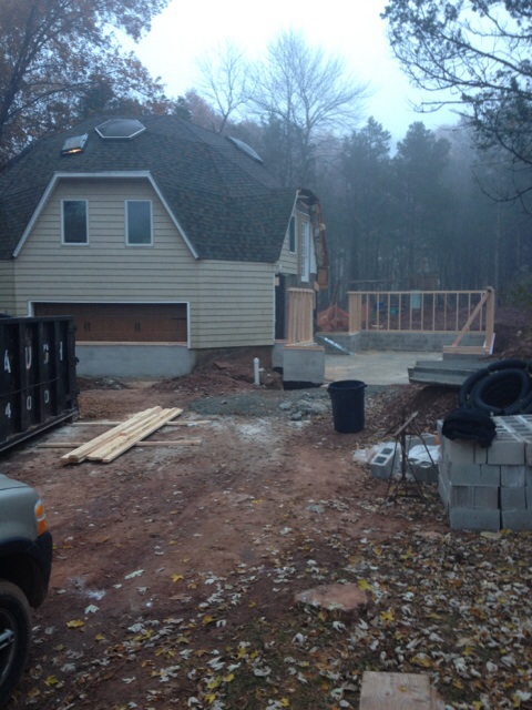

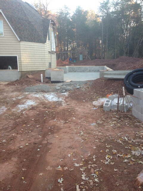

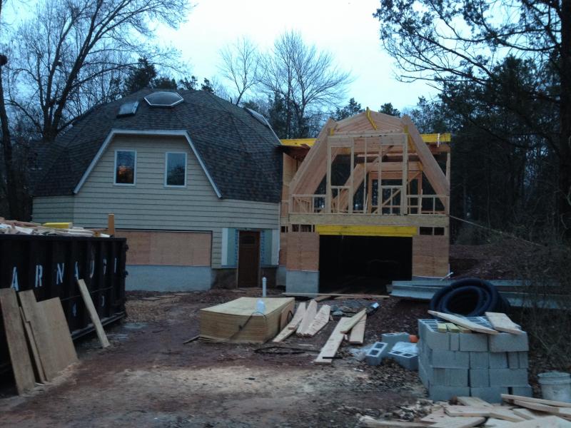

New front entrance was cut in and the roof is beginning to be framed. Funny, I figured the framing would be done by now. They're working everyday (weather permitting) so I'm not complaining, it's just that all my experience comes from large scale construction projects. Guess I'm just not used to 2 man crews, lol.
Thanks HT413 . . . cool stuff ( even if it is going slow ) . . . they're making progress . . . LOVE your house . . . wish I had one like it ! ! !

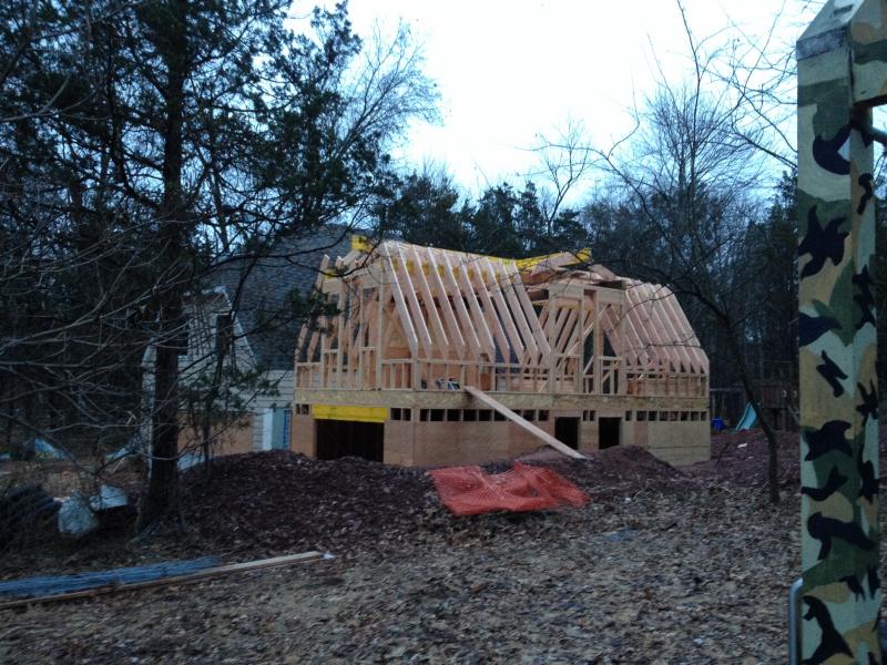

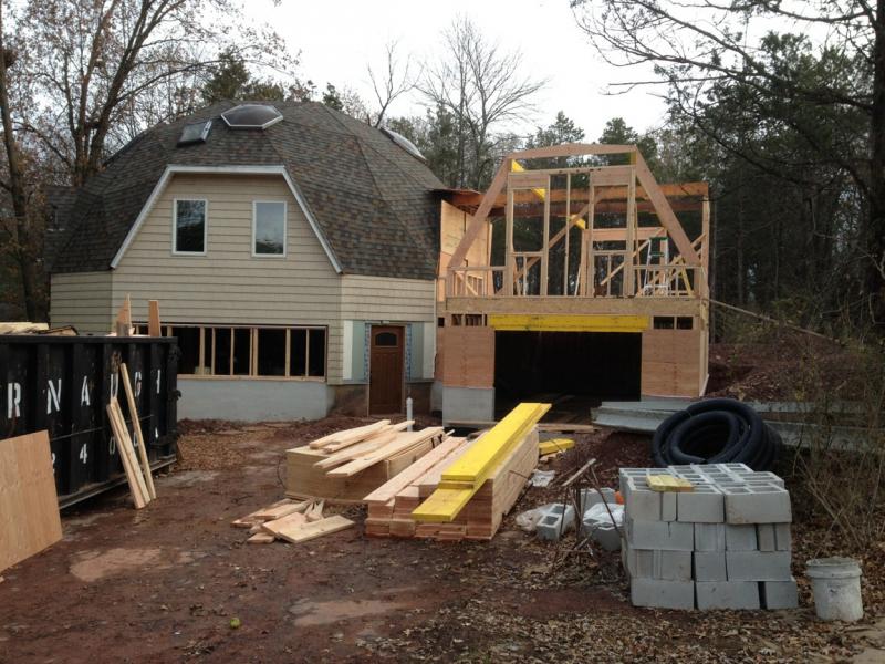

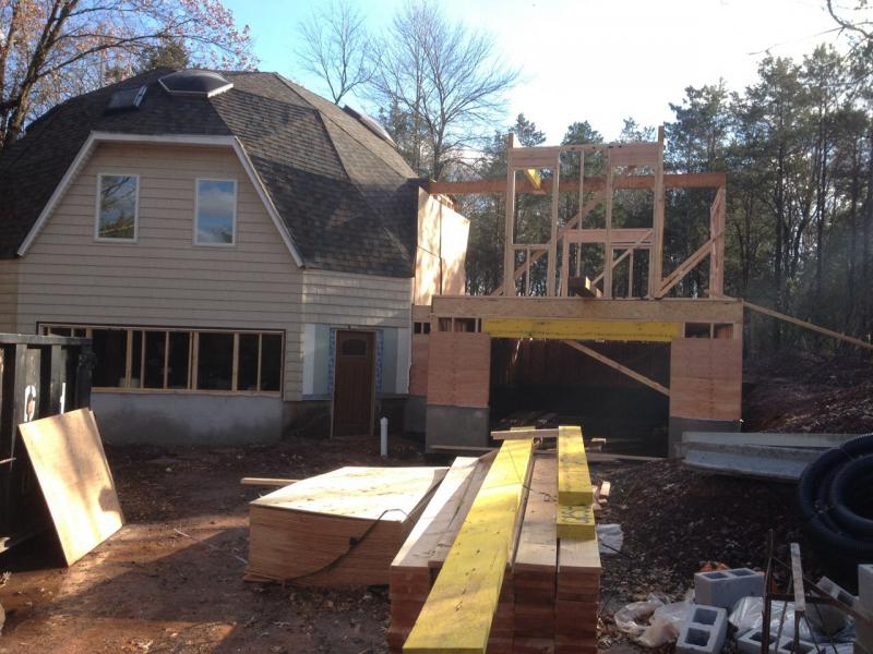

Ok, so the GC had to fire his framing crew. New one on the job and FINALLY we are getting some decent production. All this in one day.
So I thought with all the members we have throughout the world, I thought it'd be cool to compare our local building practices. So framing wise, our framing is typically 16" on center, or about 0.5m on center for all wood structural walls, floor and roof framing (pretty much standard throughout the USA for residential construction).
My house is 16" centers and so are the walls of my 28x52 shop but the roof of the shop is built on site truss (sorta) on 24" centers. Didn't get any pics to speak of since we framed it all in two days and by the time each day was done, I was too tired to think about taking pics and my X didn't think much about anything.....
Looks great.
A lot of building codes vary in structure due to snow load.
Great to see progress! Amazing how many plain old crappy contractor's are out there. Nice to hear you got a decent replacement crew.

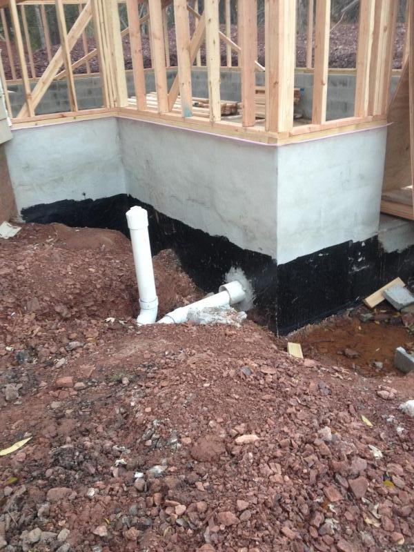

What is the freeze-line in NJ? In Texas it's around 12". What did you use to seal the cender block?
Our frost line is 36" in NJ. Hmmm, let me see if I have a pic of the sealant.

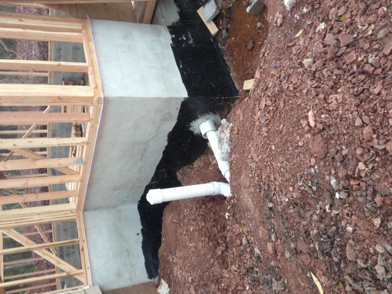

Here's a pic of the foundation sealant. First they parge the block with cement then they apply a tar based sealant. Sorry the pic is sideways, I uploaded it 3 times and every time it is sideways. Only happens on my iPhone.
