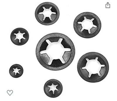

Need to replace quarter glass. 70RR conv though believe it's similar to hardtop. Got the front guide out OK, removed rollers. FSM says to remove regulator arm stud retainers and studs from frame. Can barely see the retainers, let alone remove them. Anyone done this...advice?
Maybe this picture will help. If you do a search, there a plenty of threads on that topic.
Thx for pic, but I got the FSM. My "quarter glass" search didn't turn up any removals, mostly adjustments. Looking for someone that's tackled removing the retainers in the pic above to remove the glass/frame assembly.

If they’re the circular spring clips, with four or so “spokes” they’re tough. I ended up bending them, at least two adjacent ones, and it comes off. It’s strong spring steel. You can sometimes bend them back to replace, or get new ones. Try to keep the old ones. Use a small screw driver or needle nose pliers. Not easy but it can (and has) been done.
