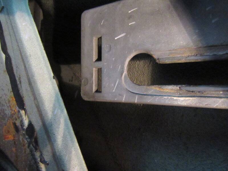

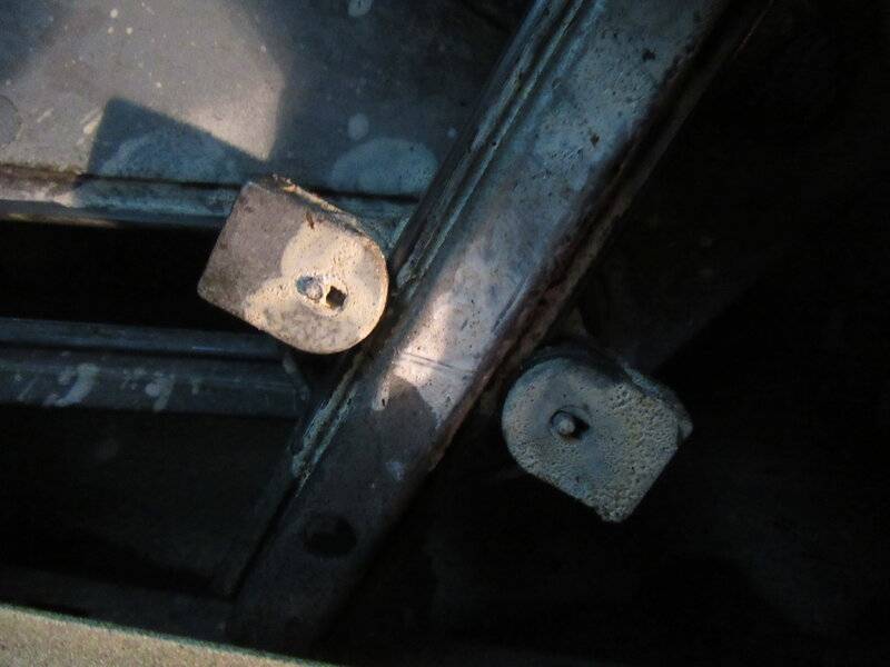

It's been nearly 20 years since I had the rear quarter windows out of my 67 GTX and I started in on my 66 Satellite today as I need to replace the outer window sweeps and removal of the glass seems the best way to do so without mayhem. However, the roller/slide mechanism doesn't look familiar to me at all from memory of my 67 and comparing it to my 66 and 67 shop manuals isn't helping either as it doesn't seem to match either. Seems like my 67 had a big roller that rode inside a C-channel similar to what the shop manual shows. Here are pictures of the roller/slides on the glass.

I figured out part of this - confusing the roller assembly on the track guides with the roller that slides in the slot of the glass frame - failing memory and confusion. Interestingly the rear roller is missing entirely on my driver side so I'll have to find someone with the roller assembly off a part car.
Still would appreciate any ideas of best way to disconnect the spring clip holding the roller in the glass frame slot to the assembly since it faces out and my arms don't have gimble joints. So any ideas would be greatly appreciated. Maybe it's easiest to unbolt the winder assembly and shift it around until the rollers slip out of the open end of the slot???

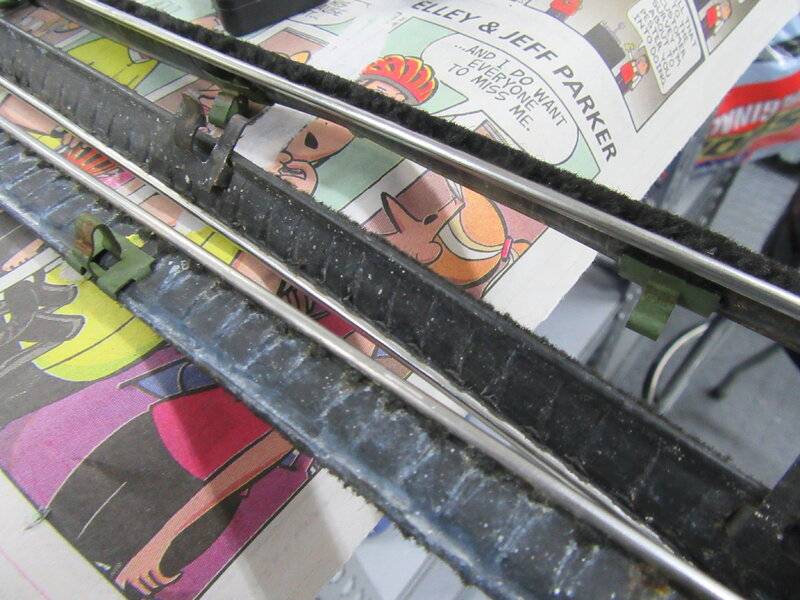

Well - it was a struggle but I finally got it out. Probably not necessary in the long run but that's what it is. There are two pivot points on the 66 that have to have the spring clips removed (on the outside of the windows so a real chore to release blindly with a little screwdriver) and then three sliding roller assemblies that have to be maneuvered to the oversize holes in the end to remove them.

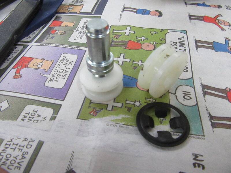

Once I finally figured out the exact type of roller assembly I needed, I found a had a couple new ones left over from my GTX refresh about 18 years ago.
t 18 years ago.
Also, not surprising but a lot of you guys are smarter than me. I found if I kept shoving the rear window down front and rear that I could eventually get it down below the window sill sweeps. Prying on it I discovered the rear sweeps have a different clip that pry out easier than the hard-to-release clips that hold the front sweeps. The lower one is the rear and the middle one is the front.
So it is possible to change the sweeps out without having to get into the rear quarter cavity and mess with the windows. Again, my car doesn't have down stops and doesn't appear to ever have had them.
Congrats, yes you figured it out. But you failed to mention the rear almost vertical channel that guides the back of the window. When the plastic roller breaks off it leaves a round ball/knob to move up and down in that track. I could not figure out how that worked until I looked at my Satellite and saw the roller. Then I realized what was missing. Now I just have to find a couple.
But other than that I congratulate you on a job well done. Not easy by any means.
Forgot to post that I did get the glass back in (without damage) and functioning smoothly. But it was a good struggle. And yes, that rear channel roller was a real pain - once I got it in I thought I would be safe in moving the window down before I put the clip on and as I did the dang thing just fell off. At least from that I did learn that it’s easiest to install that particular roller with the window down. How the assembly line workers managed to install the rear windows in any sort of speedy process, I will never understand.
