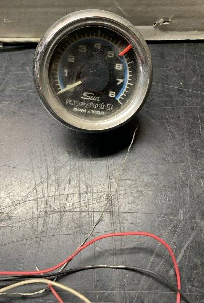

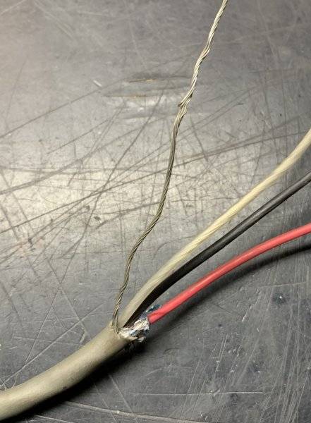

Can someone tell me which wire is the signal wire? Black is ground and white is the light. That leaves power and signal. Shouldn’t they both be insulated? Shouldn’t the signal wire be green?
Should be a green wire. Some one might of hacked in a makeshift harness. As I recall the harness plugged in the tachometer. Take it apart and see if there is a plug. If so I believe the letter is on each female pin hole. R-red[Keyed 12 volt hot],G-green[coil -],B-black[ground], W-white[light]
Ha! Correction, bare is ground. So black must be the signal wire. Weird. You would think it would be standardized and everybody would use green.
Thats not the wires it was made with.
Ya I’m starting to think the same. Don’t you love this game?

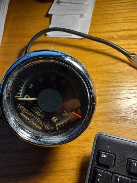

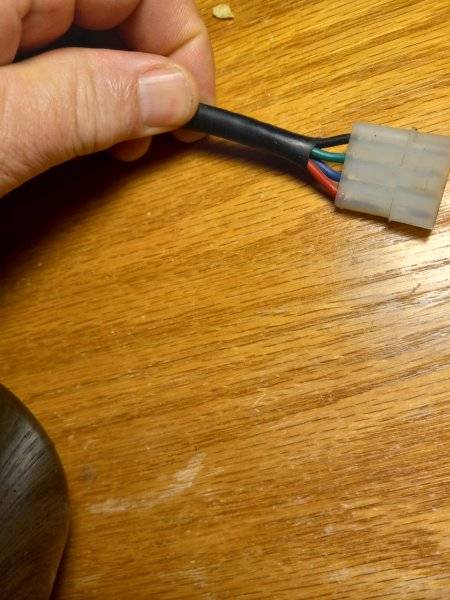

Just confirmation as I had just looked at my super tach II last night sitting in the trunk, it does have Red, Blue, Green and black.
Right. But that plug was added by someone.
That was a real hack job if ever I saw one. :lol:
Without looking at instructions...I would guess it to be;
Red - 12 Volts
Black - ground
Green - tach signal
Blue - light
Then I would test those cables and look inside for confirmation.

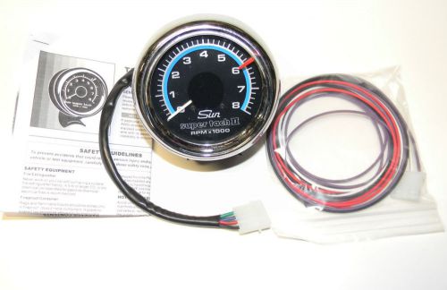

I am going to eat that statement. They must of had several wiring changes throughout the years. One of mine had a round hard connector with 4 female pins and it plugged directly to the circuit board. But here is another harness that matched the posters photo of his tachometer.
What is interesting is I don't have a white wire, seems to be blue instead?
Also, due to my ignorance, do you mean there is a place this things plugs into under the dash, or there is a board that is Sun Tach's that would be added somewhere under the dash?
Who knows why. Common to be white. Maybe they ran out of white wire. Or being white all the time was racist? [lol]
No. There were some old tachometers that had a driver module that was wired in and then the tach was wired to the module. The later ones like yours has a disconnect plug but the ends are loose and need to be wired to the correct sources.
