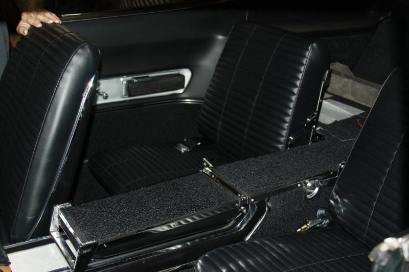

The 66/67 Charger buddy seat is basically a flip over padded arm that sits on top of the console between the seats ( front & rear seats.) There is factory welded in vertical mounting plates for the rear seat console/buddy seat. The console bolts to the vertical plates and the buddy seat bolts to the console.
First to avoid confusion for all I believe you are referring to an arm rest not a buddy seat. A buddy seat became an option on B bodies in 1967 including the Charger that for 67 the console became an option and the auto trans shifter was now standard on the column. The buddy seat was that and doubles as an arm rest in the down position.
The 1966 Charger has the full length console standard and has the arm rest pad in the front and an arm rest pad in the rear that folds forward to fill the flat fold down area with the rear buckets for cargo area
The difference for 67 in the console is that it does not run front to back as it does in 66. This was done so rear passengers could exist from either side. Other than this missing section all else is the same and the 67 still has the fold forward arm rest as seen in the link below from the 67 Dealer Data Book.

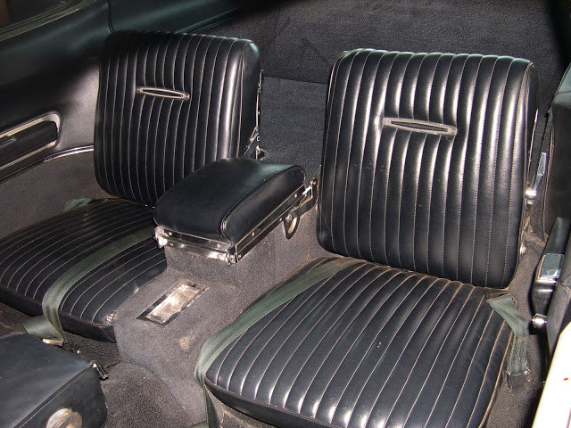

67 Charger rear- the arm rest/flip down floor extension is about 1/2 as long as the pic that was posted.
Google it. and you should find a pic.
IIRC ALL 66 had full length, only 67 had partial- so google "67 Charger rear seat".

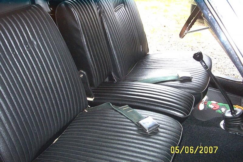

Here's a pic of the back seats in my '67. You can see part of the buddy seat there too. There are quite a few differences 66-67 in this area.
By the way- those seats pivot in the package tray sort of section in the middle, so do that swap, you'd need to rig something up or cut up the tray from a Charger, I guess.

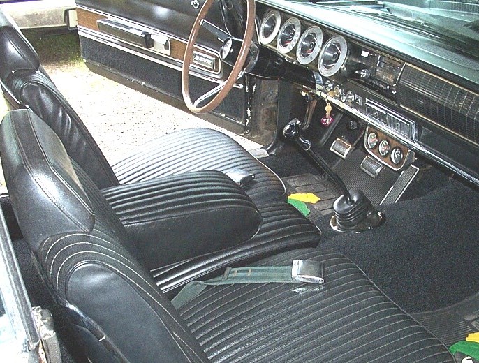

here is the front "buddy seat" or fold down arm rest as it's called....not available in 66 cars
