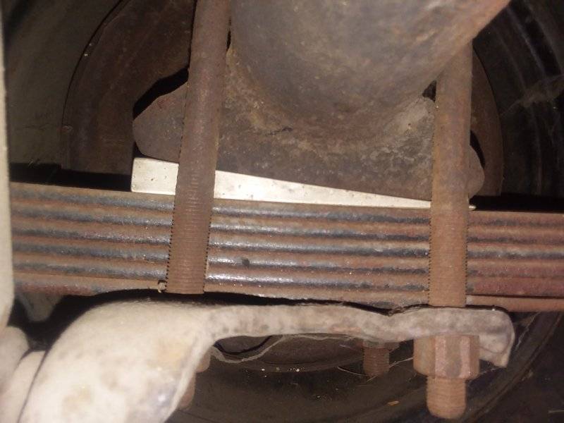

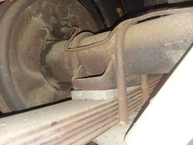

But in case of an adjustment needs to be made, you shim between the axle mount and the leaf springs if I understand correct?
I never checked mine, don't know if I should.
Yes. Between the rearend spring pad, and the spring.
