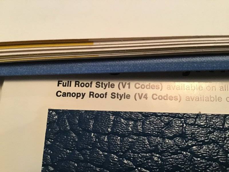

V4W is white Halo vinyl roof

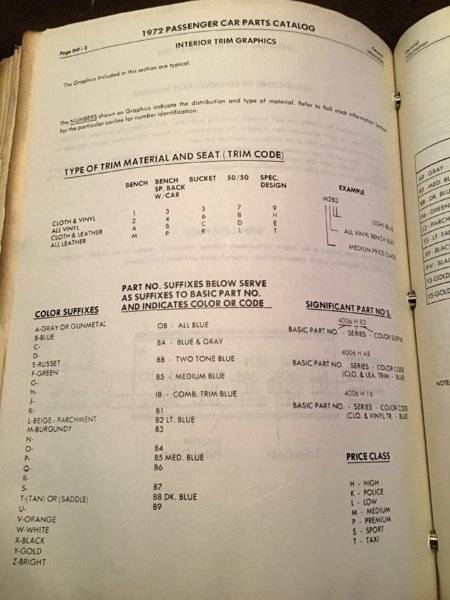

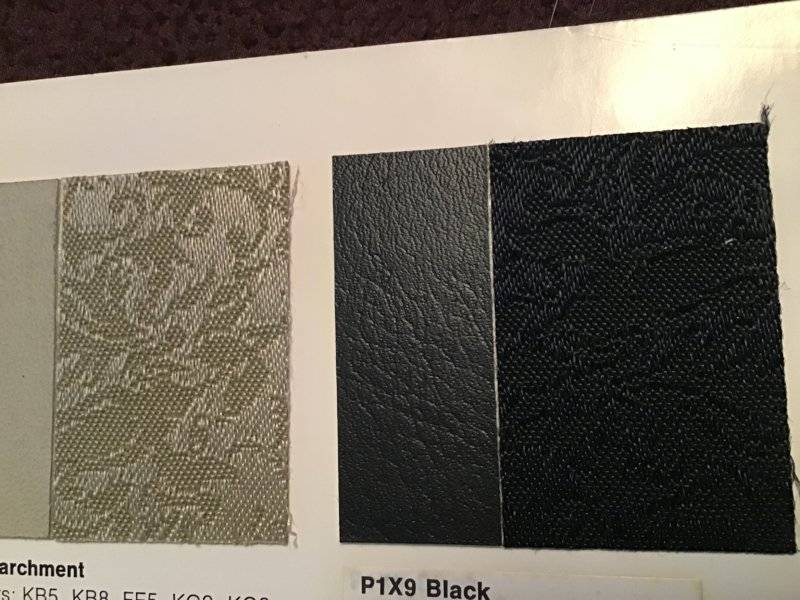

F1X9 is cloth and vinyl black interior.

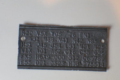

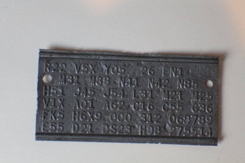

decode this one please
it's P1X9
there's rust spec on the curve of the P
P is premium on an interior code
Yes, untouched fender tag.

I’m asking if what I’ve circled on your fender tag is done on all St. Louis tags. Hopefully he’ll chime in.
