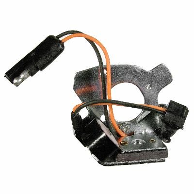

you might want to look at the air gap between the reluctor and magnet. that needs to be .008 at full vacuum advance. when the vacuum advance pulls the plate it can change the air gap. if the magnet and reluctor are touching the engine will run crappy.
OK, another dumb question by me. How do you check the gap to see what it is at full vacuum without the engine running? Do you push or pull on something to simulate it getting full advance?
I did check it again and found that the magnet and reluctor were touching, so I set it again to .008. I'm not sure how it could've tightened up after I set it to .008 the last time.

The gap doesn't change with advance, just the plate the magnetic pickup mounted on moves advanced, not the air gap itself inbetween the reluctor/pickups, stays the same... Make sure you use a not magnetic brass/bronze type feeler gauge to check, your air gap or you could/will possibly mess things up between the magnetic contacts... good luck

the air gap can change as the vacuum advance pulls the plate. the arc of the plate when pulled is not concentric with the rotation of the reluctor. thats why the magnetic pick-up and reluctor need a .008" min gap. another thing that makes matters worse is that the 8 "spikes" (for lack of a better term) are not concentric with the center of the reluctor. so what needs to happen is the vacuum advance needs to be pulled fully open and then the .008" air gap set on the "spikes" that have the furthest run-out. that means that some of the "spikes" may be .010", or a little more. clear as mud?
Sorry to be so dense, but how do I do what I put in bold from your quote above?
I think lewtot184 refers to the lobes. The gap can change from lobe to lobe, depending on wear. I average all the gaps on the bench, and find what works best. .001-.003 is tolerable. the Increased voltage makes up for the variation.
