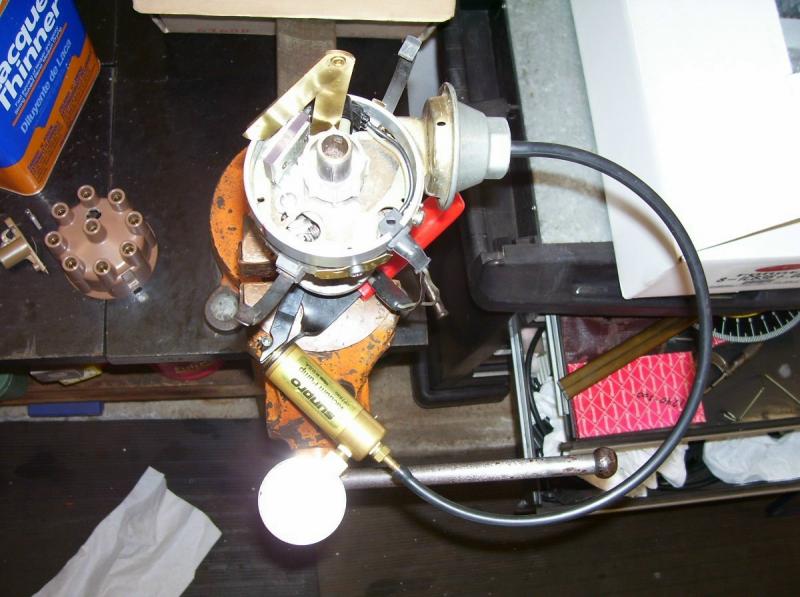

this isn't a good pic but, i mocked up a distributor in the vice, pulled vacuum with my vacuum gadget, and stuck a brass feeler gauge between the reluctor and magnet. this is how i do it. i can't be done in the car. distributor needs to come out.
