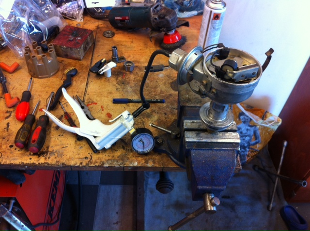

The next issue was the vacuum advance, it is marked with a 9 and I guess it means 18 degree advance, I took my new Mityvac and measured it to around 16 degree so I guess 18 is correct.
First it was really hard and it needed 15 in/hg to start working, I took a hex key and adjusted it so it starts pulling at 10 in/hg and have full advance at 15 in/hg, that is the lowest I could go on the adjuster.
