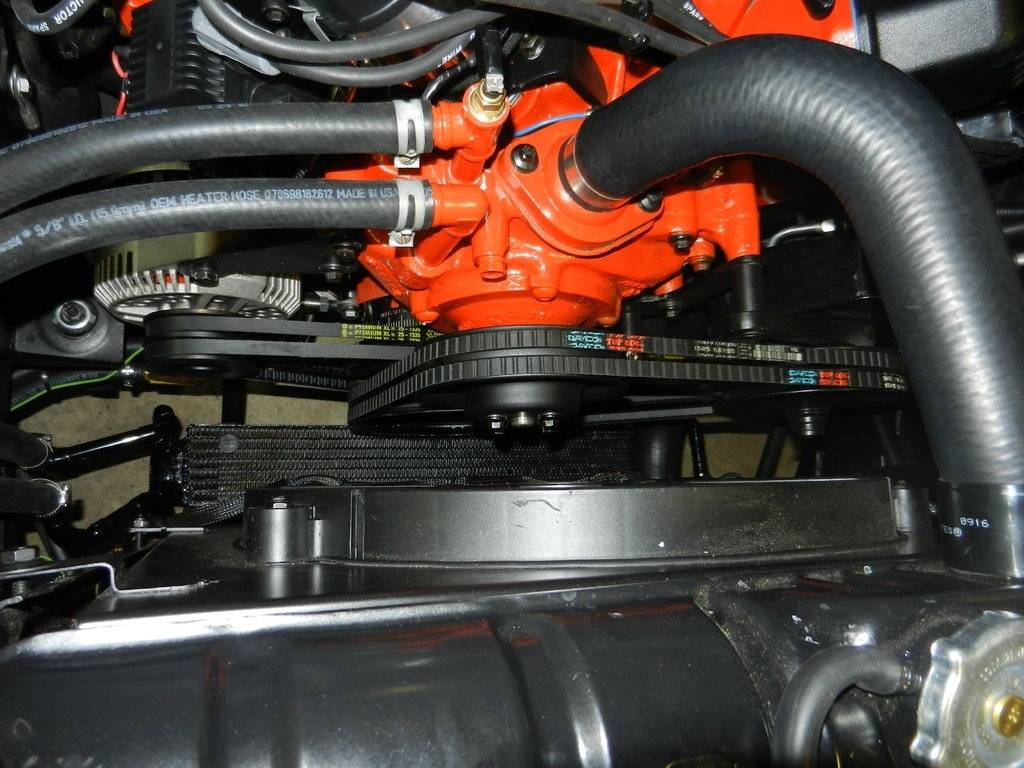

Here is a pic looking from the top down using a 4 groove lower pulley. I need this setup because with high horsepower you can literally burn the belts up due to slippage on acceleration. I ordered the water pump pulley from Bouchillon, they are the only people I trust for high rpm pulleys.
Nice setup. I like it. I'm going with this setup on this motor. Here's the pulley:
http://bouchillonperformance.com/inc/sdetail/868/903
So, what pulley do you have on the power steering pump? The site say to use the idler for the 4th belt but nothing about the double PS pulley you're running. Looks like a Dorman 300-125 would work.
http://www.dormanproducts.com/itemdetail.aspx?ProductID=17637&SEName=300-125
Btw, what belt sizes are you using for the alt and the wp/ps? And are the heater hoses running into a cooler for extra cooling?

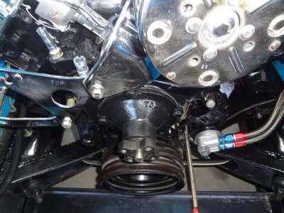

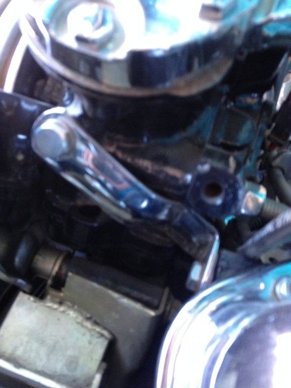

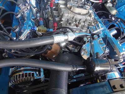

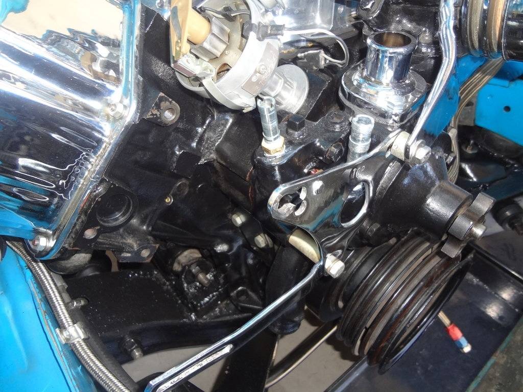

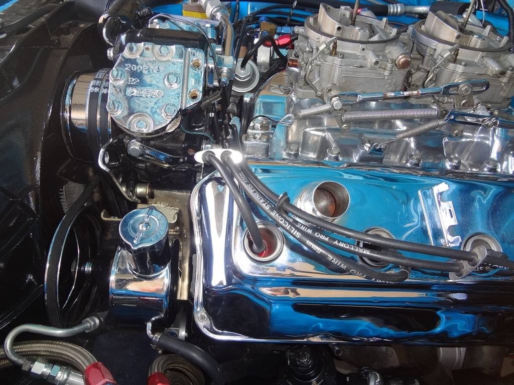

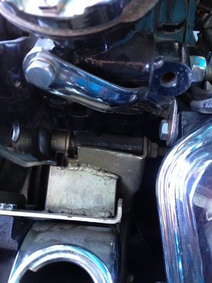

I can testify regarding "Pulley Hell"

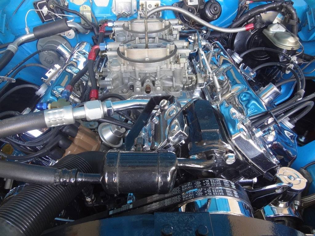

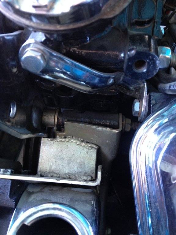

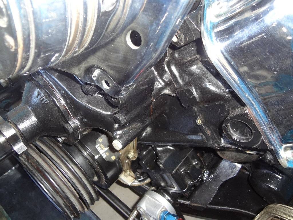

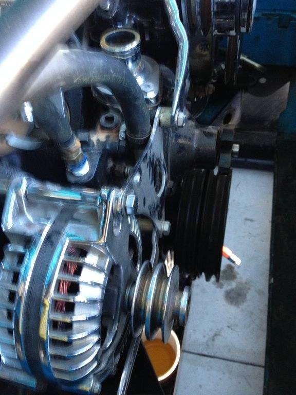

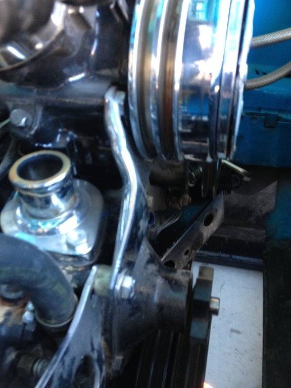

I went thru withdrawls when I decided to adapt my original 440 A/C Compressor to the Hemi and retain the authentic Duel Quad Hemi air cleaner. I wanted everything under the hood to resemble the way Ma Mopar would have added Air to a Hemi in the day.
I ended up moving the Compressor forward just enough to clear the Hemi Air Cleaner. Then I had to modify an early BB Power Steering bracket to move the Power Steering down to clear the A/C compressor. Alternator bracket is a early BB. I used a combination of Hemi and my 440 pulleys with modified spacers for belt alignment. The biggest obstacle was the fan back spacing. The back of the fan blades interfered with the compressor pulley when I got all the belts to align up. I had to make a spacer for the water pump flange and shave the back of the fan blades to get clearance. it was fun shaving the fan blades and maintaining fan balance.
All in all I got it to work. Here's some photos.
I'm a little confused as to what I see in the pic. Two belts from the alt straight to the crank?? and two belts from the WP to the PS pump?? Double pulley on PS pump?? I have a 4 groove crank pulley and want to replace the one groove WP pulley with a 2 grove so I can delete the AC.
