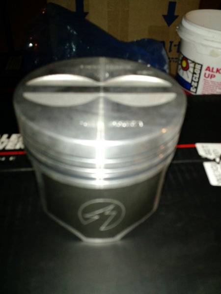

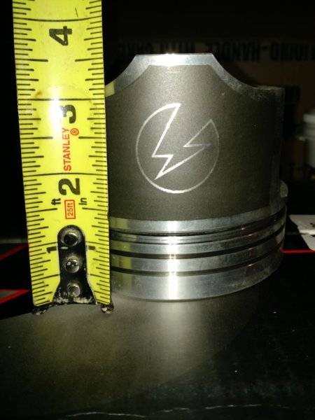

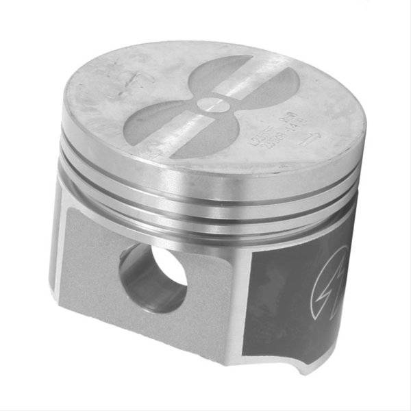

Wow, I just looked up the weight on those 2355 pistons, they're coming in at a whopping 1097 Grams with the pin! Ross dome pistons, with a Chevy pin, for a 451 weigh 696 grams. That's one nice thing about reduced C Height. No wonder that motor will rev to 3000 RPM almost instantly! At 3000 RPM, the piston is changing direction 100 times a second. Reduce reciprocating weight as much as safely possible.

The 440 has a Compression height piston of 2.067, best case. So that makes for a large, bulky, heavy piston. Put that same 3.75" stroke crank in a low deck block, with the 440 length rod, and Voila! You have a C Height of about 1.320". So the piston resembles a (dare I say it) lightweight small block chevy piston. And we know how well those things rev! That's just one of the many benefits of the 451 type motors.
Yes, the long skirt of the 2355 is not only heavy, it also increases friction on the cylinder walls, robbing horsepower.
