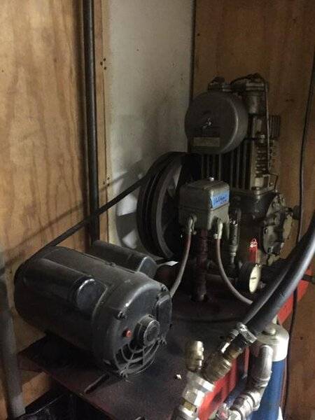

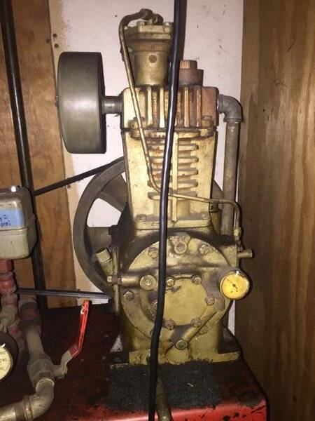

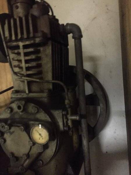

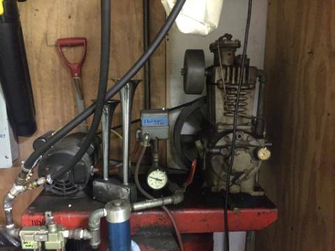

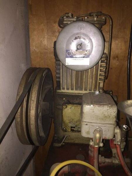

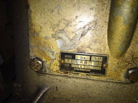

Gents! Need to tap the vast wealth of knowledge here to try and repair my old Quincy 219-39 air compressor.
Now, I want to fix this olde girl and keep this setup. So to everyone who'll say just buy a new one, thank you, but that is my LAST resort and will cross that bridge if I get there. She has been a great little compressor for longer than I have been alive with minimal maintenance.
It all started when I walked into the garage one day and it running (filling), but it was making an odd sound. So I turned it off at the breaker. I proceed to turn the flywheel and it makes a "blooping" noise like it lost compression in the head.
I want to try and fix it myself, but am not opposed to getting a pro in here to fix it either. I have a decent grasp on mechanical items (and lotsa tools as well), but have not torn into an air compressor engine before.
So my question is, where to start? Obviously need to narrow down exactly what I need to fix and not go on a parts changing spree just to find out it didnt get fixed. I can get more detailed pics and a vid if need be.
Thank you!

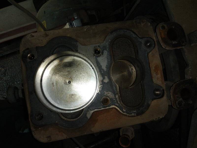

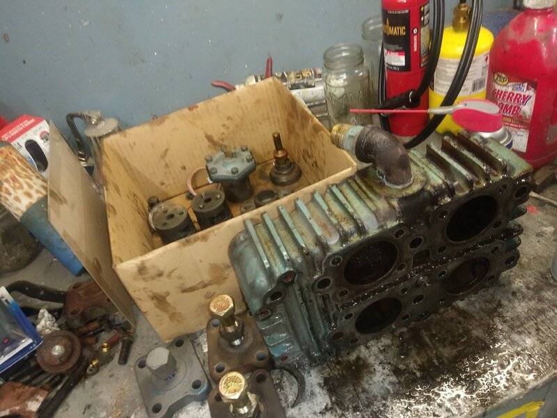

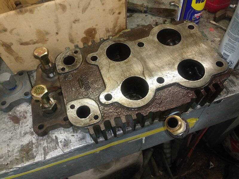

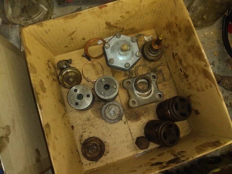

so I start opening up the top end, everything clean except the top of the high pressure discharge valve assembly...... lol, I became an expert this week.
there are no moving parts! I didn't expect that
the valves are just sorta like flat washers sitting on a spring. they move according to suction and pressure who knew?
I never really gave it any thought, never had to....... the thing just runs
anyway the valve assembly gets held down tight into the head with a jamb bolt and a lock nut, there is a copper washer at the bottom where it seats into the head.
evidently, the high pressure discharge valve assembly at the top is a point of condensation and gets rusty.... probably from not running enough, long enough, to get hot enough; imo
turns out my hold down lost enough material to loosen up the valve assembly...... that was my knock
hardest part was extracting the all the hold downs...... 2 of them broke off, even with heat. I made my own
Thank you!
View attachment 1232475 View attachment 1232476 View attachment 1232477 View attachment 1232478 View attachment 1232482 View attachment 1232483

page 12 is what I was referring to...... #13 gets torqued down and seats #12 into #2 which is a copper gasket
my #12 became loose due to corrosion........ nothing there moves except for the little valve disc which reacts to pressure and suction.....basically no moving parts that require lubrication
