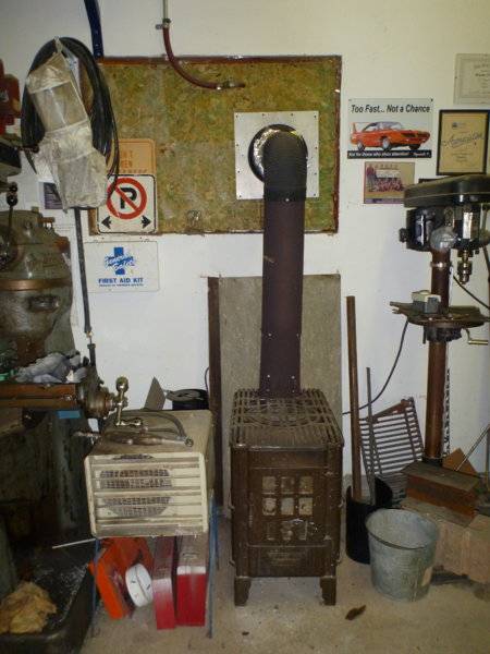

I'm glad of that, given the amount of combustibles in there, ya packrat. :)
No worries, I haven't burnt the place down in 23 years with it sitting between my Bridgeport and Drill presses.
Love those little rascals. :)
All except for the care and feeding part... there is a warmth you get from a little stove
like that that you just don't get from any other kind of heater.

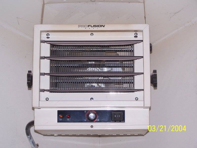

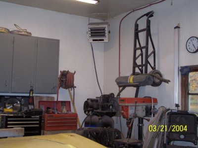

Small shop (approx 630 sq with 11' flat ceiling and one ceiling fan) attached to my home so only 3 walls exposed to central Michigan winters. It is heated with this 240 V from Menards. I usually keep it around 60 but can easily run it up to 75 when I paint. Has 3 1/2" fiberglass in the walls and R-38 over the ceiling. Never checked how much juice it sucks but I didn't hear the head bill payer say much about it so I would suspect, not much at all. Had it about 3-4 years without a problem. It can run at 3,4,or 5K for watts but I never move it off the 3K setting. Pretty sure I paid less the $200 for this and it does the job just fine.

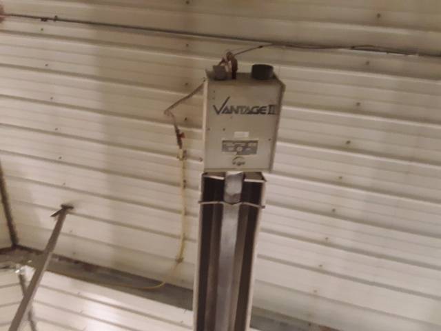

Our main building is aprox 60 x 40 and 16' center height, spray foam walls and ceiling then steel lined.
We have had this pair of vantage tubes in since early 90s , they do a great job even in the below zero weather.
separate 220 electric heat for the paint booth.
Im a fan of the tube heaters , nice even heat.
We really need to clean the reflectors lol.
