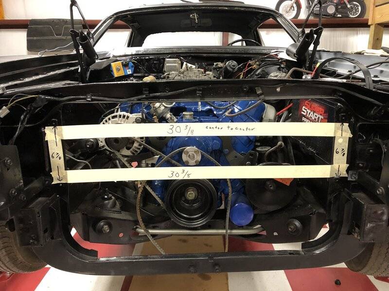

If you can tell by my picture, both the top and bottom mounting bolt castle nuts are exactly 30 3/8 inches apart and 6 ⅞ apart vertical wise. My fender tag is indeed stamped 28, for a 28 inch rad. I found a Champion that is listed for a 73-74 only and those dimensions do look correct for a straight bolt in. I let ya know when it gets here. If it doesn't fit, next step will be to fab a bracket.....
