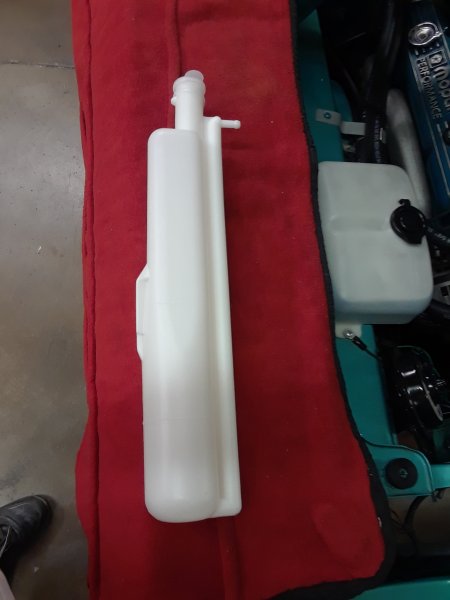

Dorman part. From Summit. I think it's a Mitsubishi application.
Keep in mind having a coolant recovery keeps air out of the cooling system. No air reduces oxidation.

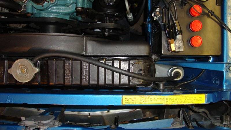

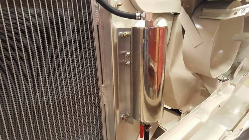

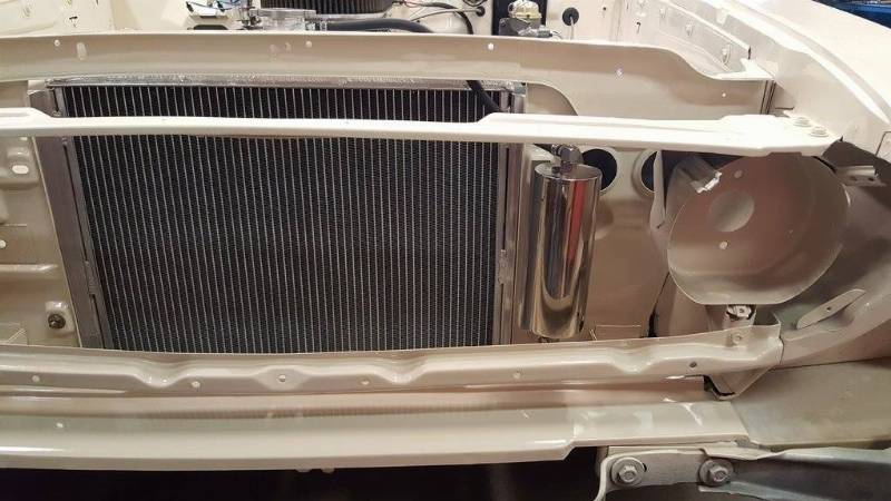

In my 62 Belvedere, I welded up a 10" section of 2-1/2" exhaust and use that as an overflow tank.

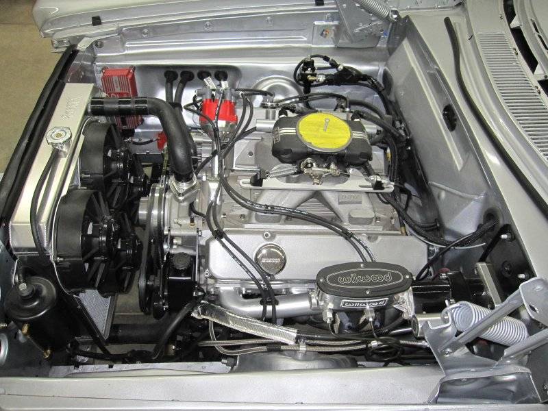

There are tons and tons of clear plastic expansion tanks available these days. I just grabbed one from a new car that fit pretty well and built a little bracket for it.

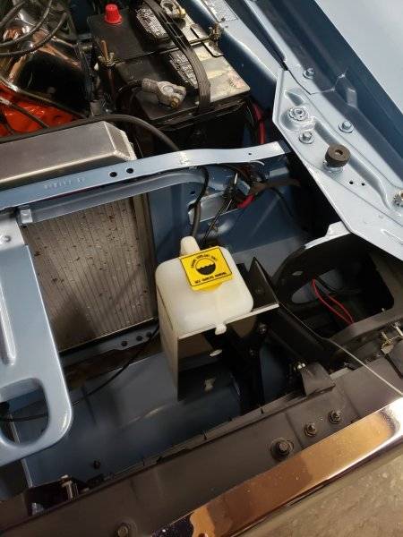

For many 66-70 B bodies, the 73-76 A body overflow jug fits and works quite well.

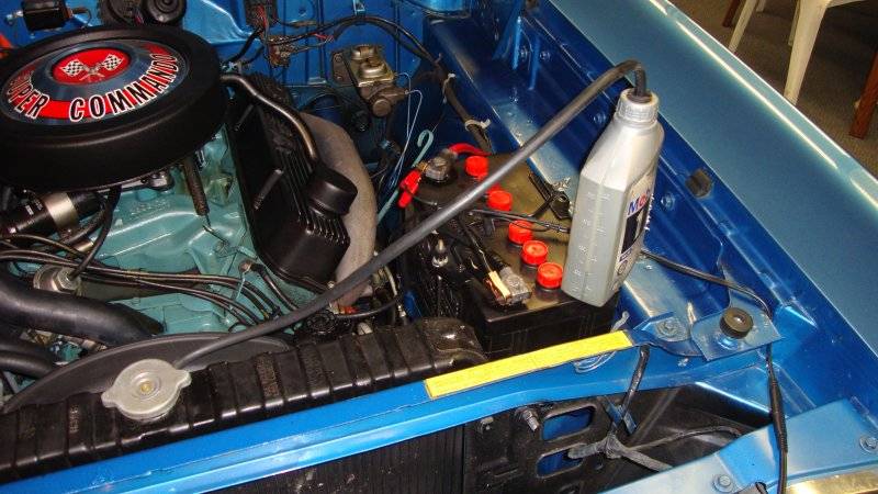

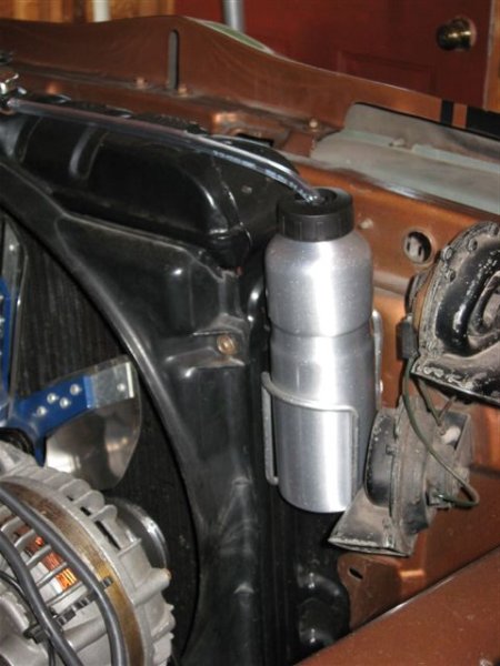

Mobil1 Oil bottle...rinsed well of course. Fits perfectly in the space.

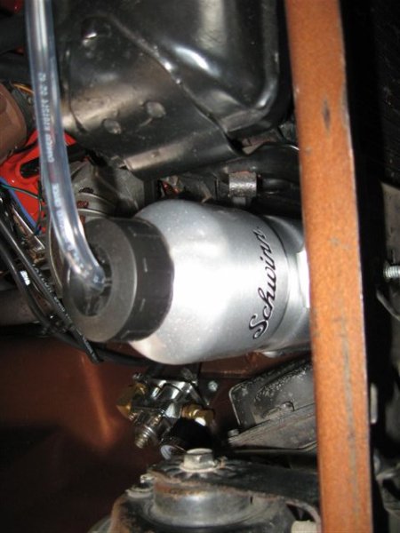

I found a nice spun aluminum tank, it even came with a tig welded aluminum bracket. Just turn the Schwinn logo to the backside. LOL

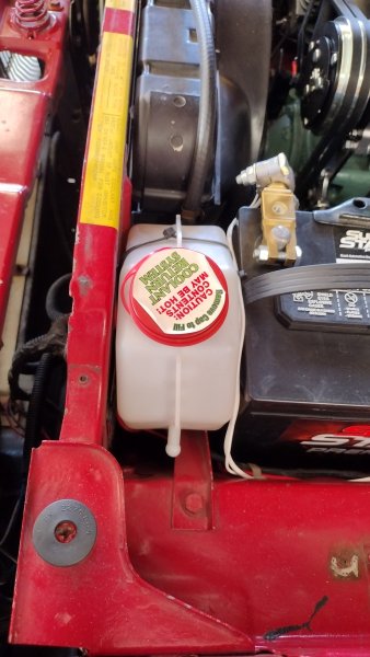

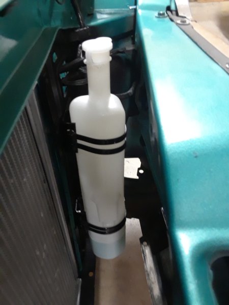

Universal O'Reilly's tank. Zip tie in place.
