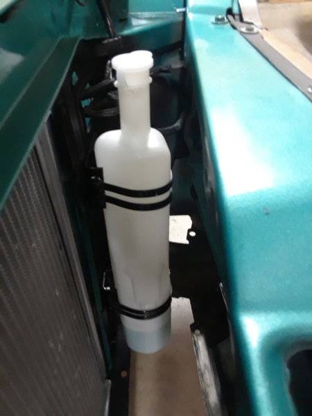

Mine used to puke out of the overflow hose (no overflow in '70). I added a cheap "long bubble type" overflow that I picked up at a swap meet...many people sell them, about 16" long/6" diameter/drain lever on bottom....you need something for the track anyway. So....I later replaced my stock 26" radiator with an el-cheapo 4-core aluminum Champion (not the best fit, but works) and the car never puked again. My puking issue was the radiator not quite up to snuff.
