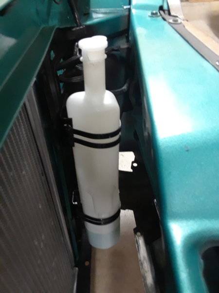

That looks like it should be factory.
I used the existing holes for the condenser mounting. Had a bunch of surplus Wi-Fi powder coated antenna mount at work. Zip tied and done. Works great and everyone compliments at car shows.

Went with Billcom's idea, zip tied it in and good to go. Thanks man!
I get asked about this so much at car shows I keep the Dorman part number in the glove box.
