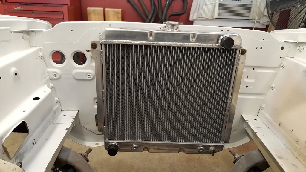

Upper Radiator hose is in the wrong location for a BB. Should be on the RH side.
Thats a crossflow.

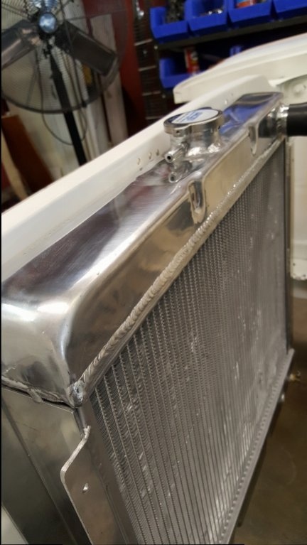

I'm useing this one. Lower passenger hole doesn't match origanal location but a drill will fix that. I like the outer flange for mounting a fan shroud without the fasteners going through the core area. It sits a little lower than the factory radiator but I'm going to adjust that too. Can't beat the price. Check out their print for the measurements.

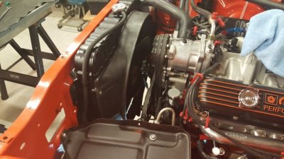

Buy a hose with right diameter both ends and cut to fit. I would like to known if there is a good reason this wouldn't work. Is there a reason for the hose to be on passenger side? Re-cored 318 radiator to a 4 row. No overheating problems with mine.

I've seen a lot of people useing the center hose. Makes it easier to get to the dizzy.
