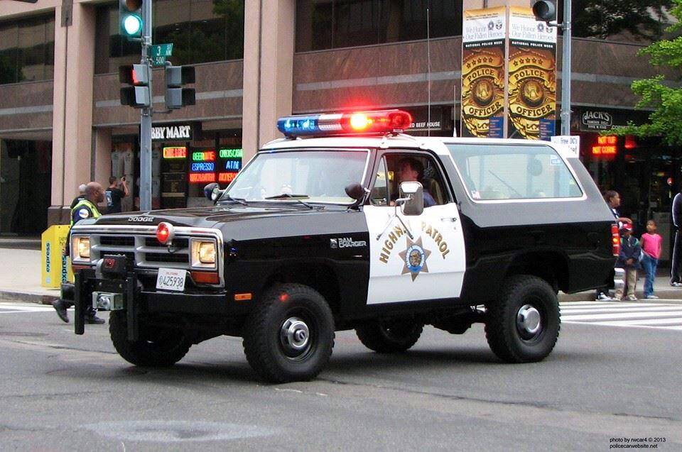

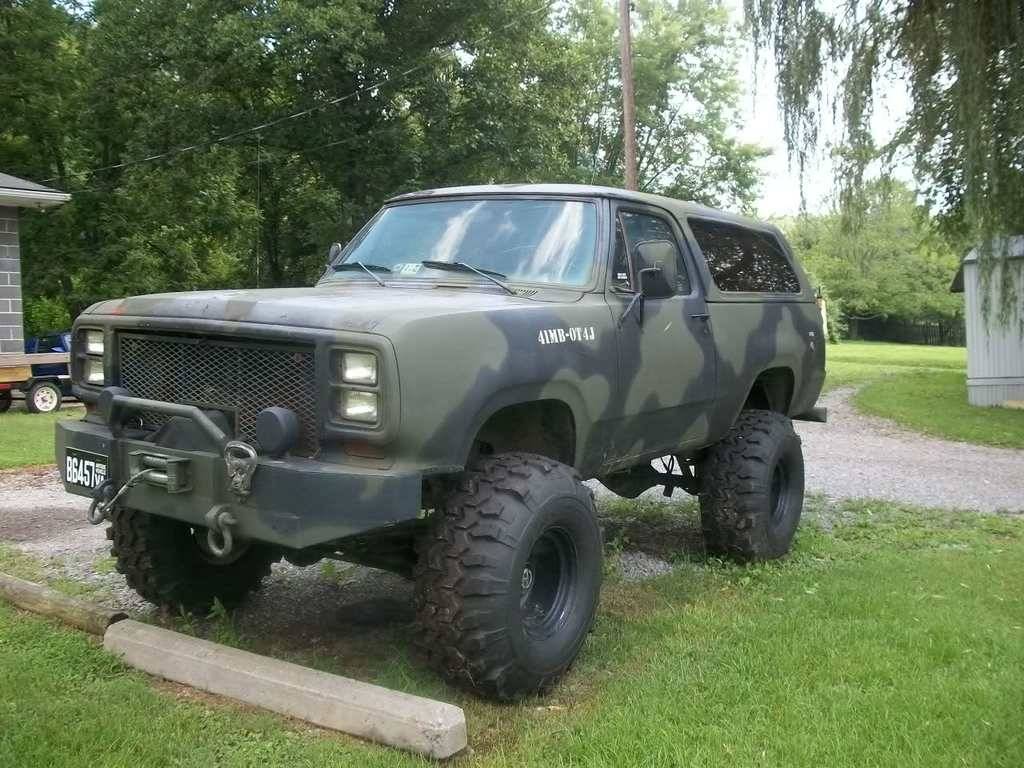

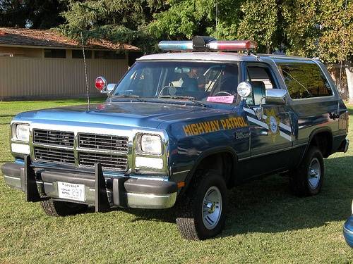

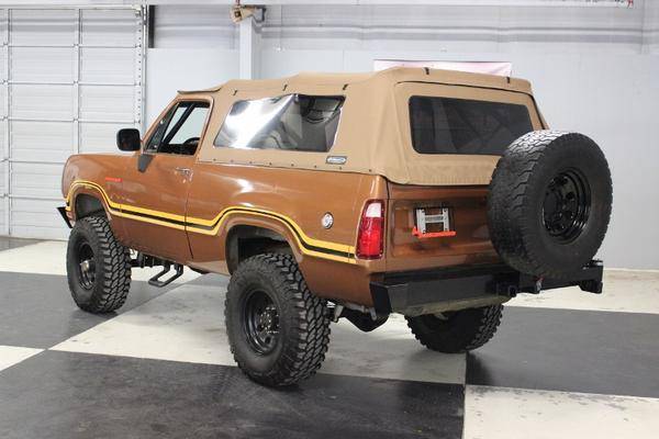

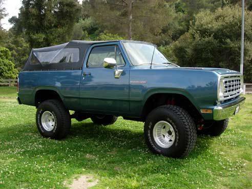

at one time I used to see them come through some of the military auctions always wanted to pick one up but never found the one I had wanted also a lot of law enforcement agency got them to
you also could get the soft top for them
not sure if this was a military truck at one time or converted
