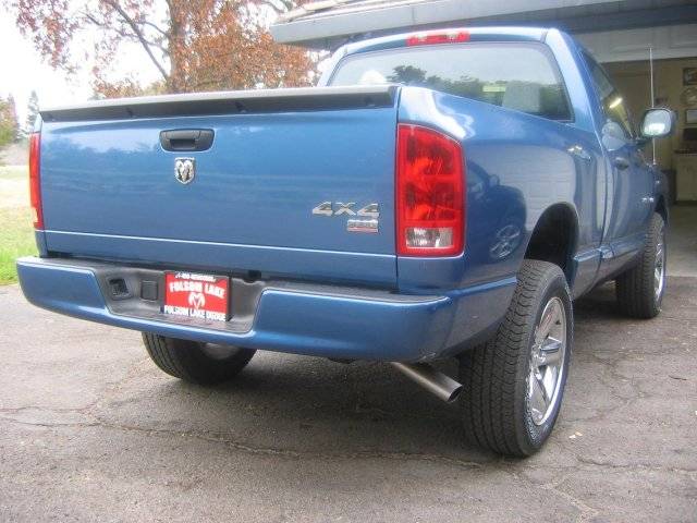

In 2002, I got tired of patching and "band-aiding" my '84 Chevy. I was in the process of trying to "restore" my red '70 Charger and I was spending too much time on repairs and maintenance of the Chevy just to keep it running for my job.
In April 2002, I bought my FIRST new vehicle ever....
2002 Ram 1500 in the then new 3rd gen body style. 4.7, automatic with A/C and not much else. Rubber floors, crank windows and a single CD player. Within a few thousand miles, I lowered it.....

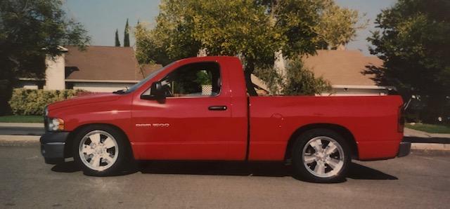

I ran that truck for just over 4 years and sold it with 163,000 miles on it. I had an itch for a 4wd so I bought this:

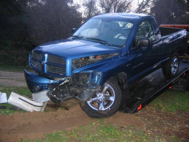

Great truck....the 5.7, SPORT equipment, power everything and comfortable. I was hit in the LF corner at 33,000 miles and knocked into a barrier...

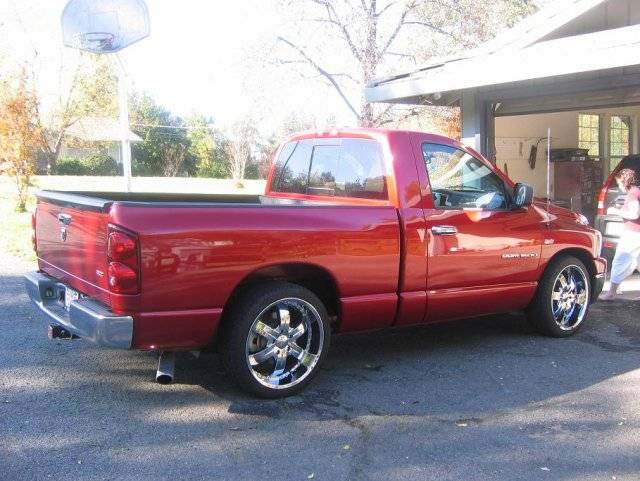

In 2013, I swapped on these SRT 10 replica wheels...

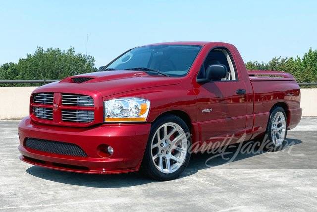

I have always liked the look of the SRT 10 trucks.
They were THE first production pickup to top 150 mph in stock form. The 2004 SRT 10 with the Viper sourced V 10 and 6 speed manual trans was the lightest and fastest production truck up to then.

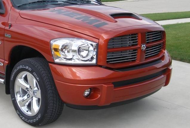

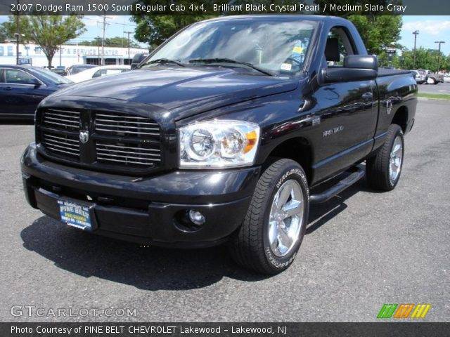

I liked the look of the SPORT models with the fully covered bumper like my 2006 truck....
To mimic the look, I just found a municipal truck black front bumper and painted it body color.
Most Dodge guys and certainly Ford and Chevy guys wouldn't think that it wasn't stock. I liked the look but the painted steel does have drawbacks...

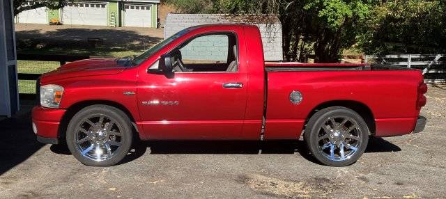

Top picture is my truck:
The body and paint are still pretty decent for almost 400,000 miles! I have not waxed or buffed it in years but that is coming....

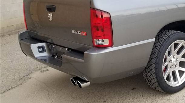

There are several differences between these models. The SRT 10 has a different front bumper cover with a deep air dam. The bed has a small spoiler on it. The wheels are different and the chassis sits lower than the regular trucks. Finally, for aero, they added body cladding to the sides to make it more favorable at high speeds.
A few weeks back, I found a wrecking yard that had TWO of these trucks in the yard. There were about 10,000 of these trucks built over three model years so they are not very common compared to the 1500 series.
For $1500, I bought the 10 pieces of body cladding that attach to the sides. They consist of the one behind the front wheel opening on the fender, the one on the door, behind the door, on the bed forward of the wheel opening and behind the wheel opening.
The rearmost panels wrap around the bumper like so:
The SRT 10 rear bumper was another $1500 but I didn't like the design. It has a single oval shaped cutout for the twin exhaust pipe those models used. I have dual pipes on mine....

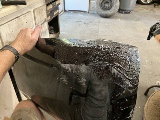

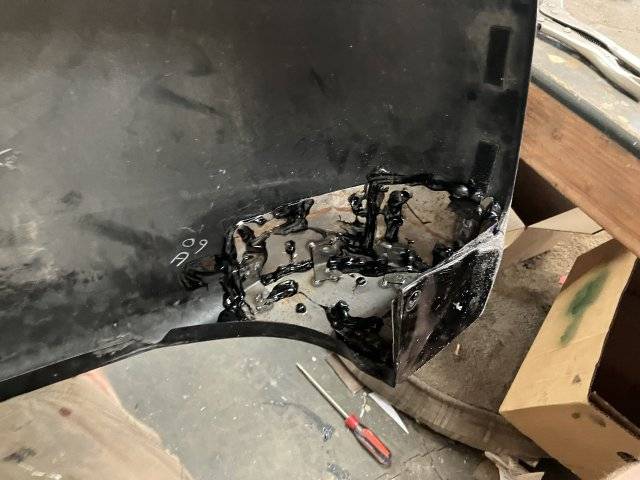

The cladding pieces I got are nearly perfect except ONE. The left side was ripped and needing repair. I test fitted it to the truck to make an assessment of what to do.
I have never tried repairing any bumper covers before but armed with some YouTube videos and some confidence from my bodywork supply salesman, I took a chance on it.
I first pulled the panel all to the correct shape, then put strips of duct tape on the face side to hold it into place. the back side was cleaned with lacquer thinner.
I first thought of using the 2 part epoxy with metal type screens attached to the back side to hold it all from spreading but then had the idea to make a metal cage to perform 2 functions; ONE to serve as an anchor to hold it all together and TWO to provide support for the panel should some idiot try to step on it to get into the truck.
I drilled a series of holes in it to allow the epoxy/adhesive to better imbed itself into the cage.
The epoxy is supposed to have a 45 second work time....Yeah, 45 seconds from when you squirt it onto the panel to when the stuff hardens. Holeeeee crap that was frustrating! It was maybe 15 seconds or so before I thought I was screwed. I used the double cartridge applicator gun and pressed out the epoxy, then grabbed the metal cage to set it into place. I almost didn't make it. I wanted to smooth out the globs but it all hardened up too damn fast.
Not exactly the work of Pablo Picasso.....
The stuff set up quick and within 15 minutes, was as solid as anything I've ever seen.
I pulled the duct tape off the face side, wiped it down, sanded it to make a good surface, wiped it down again then applied more of the epoxy....

Just to be safe, I waited a day to sand on it.
It needed more work but was as solid as can be. I wasn't confident to use regular body filler under the thought that any flex in the panel would crack the filler.
My auto body supplier thought that with as stiff as this is now with that metal cage glued to the back side, this dude wasn't going to flex so I went ahead and applied some RAGE Gold filler in three steps.
It is looking like it is going to work out.

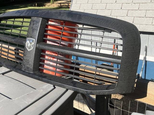

I like the body color grille, my truck has this chrome one:
....so I bought an unpainted one from the wrecking yard....
It has unchromed and unpainted black slats in it....I am unsure if I'll use these in black or reuse the semi chrome ones from my chrome grille.

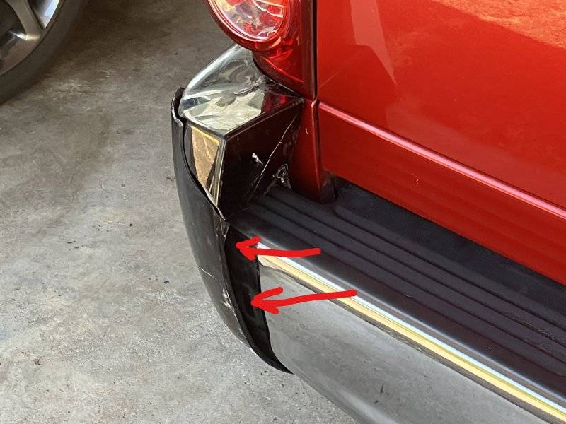

When I first started looking at these SRT 10 cladding pieces, I thought that they just fit right at the bodyline right here:
I was wrong. They sit above that bodyline a few inches....They actually sit just below the taillight lenses.
Note how tight the rearmost cladding lays over the edge of the bumper.

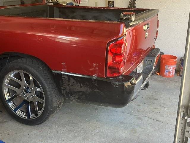

A test fit on my truck showed a small problem:
There is about 5/8" to 3/4" gap there. This is with the panel sitting where it should sit. This tells me that the SRT 10 bumper was a bit deeper in design. My fix?
The bumper can be spaced off of the frame to close the gap. I may need longer bolts but it should work.
