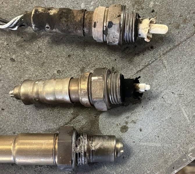

I got a code for the RH upstream O2 sensor, so I bought a pair. Check out what the old ones looked like!
Top is the LH sensor, middle is the RH one, bottom is new.
Strange, huh? The barrel below the threads are shredded.
With the new sensors in place, it idles great, has more power, gets a little better mileage and puts out NO codes!

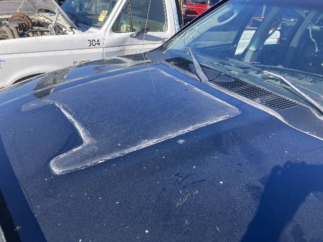

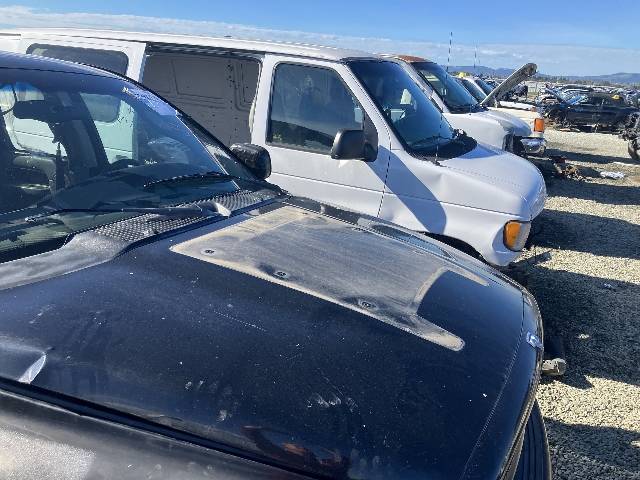

This was on the list:
I wanted the hood scoop. My truck has one but I wanted a spare to paint and swap when I do the rest of the SRT stuff.

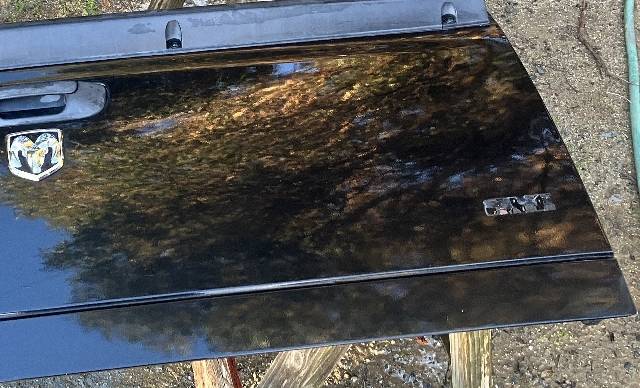

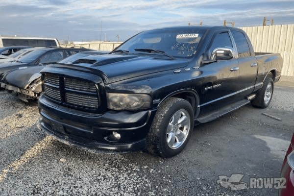

I walked up on this:
They had another black truck, but...
The trucks there had trashed bumpers and wrong year taillights.

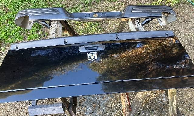

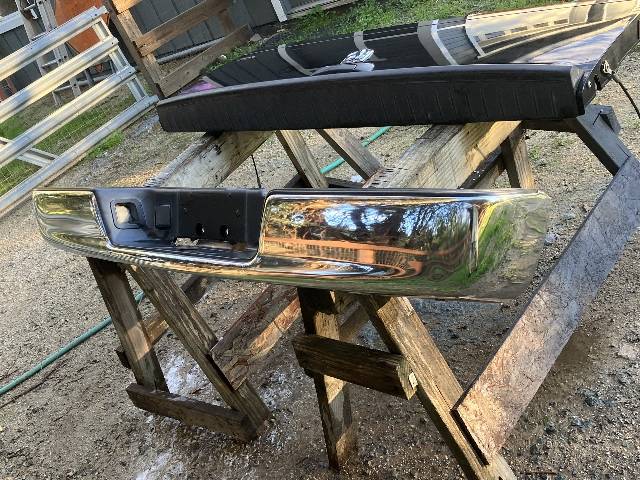

Yard #2 was smaller and off the beaten path but had ONE truck that had some great parts left.

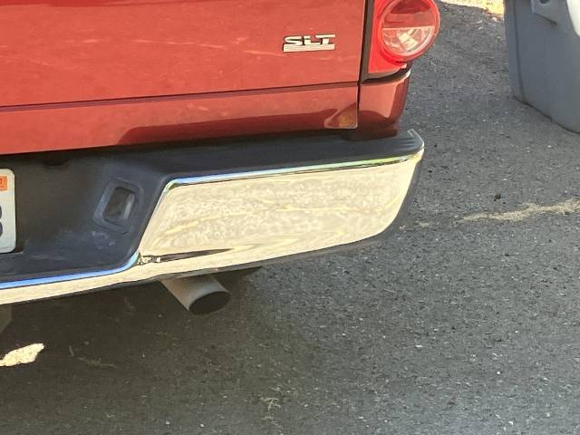

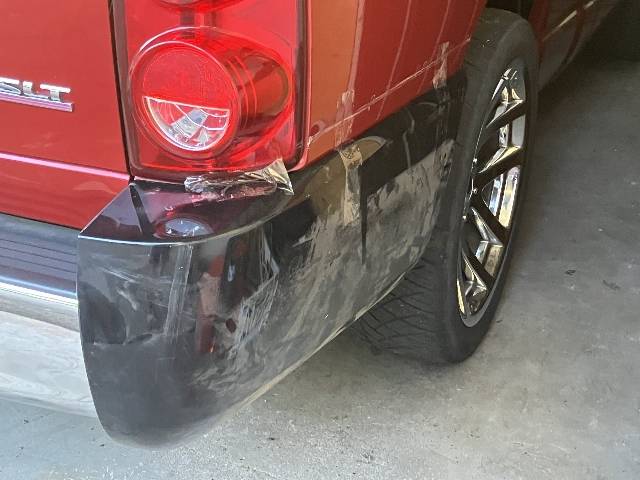

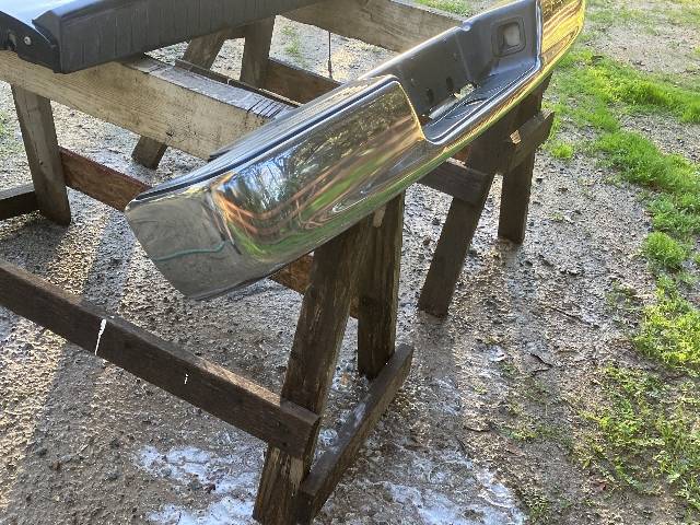

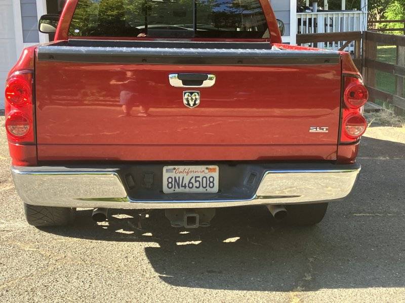

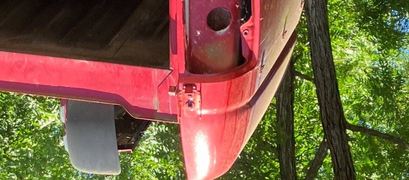

I got this bumper...

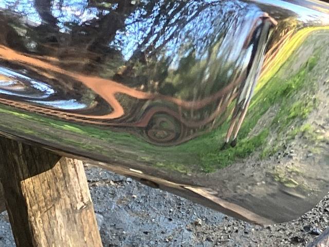

Only one tiny ding in a place that will get hidden by the corner of the right rear SRT cladding piece.
This bumper is otherwise straight. I'll sand blast and prime the chrome. It will get painted and cleared to match the body.

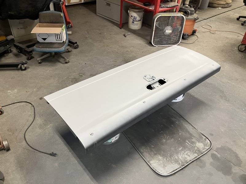

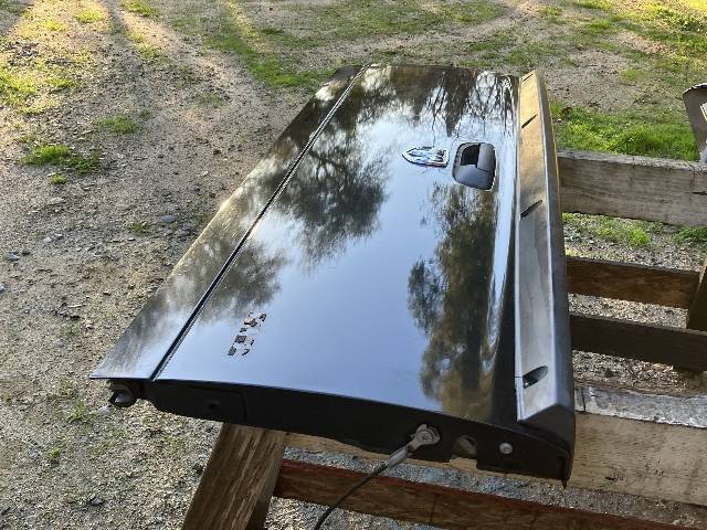

I also got this tailgate...
There is the two sided tape residue from the SLT emblem. I'll clean that off. I'm not sure if I'll add my own SRT emblem.
The back side was coated with that spray in bedliner stuff.
It is still in great shape. I'll prime and paint this and swap it in and save the original for a spare. The original has a few dings...

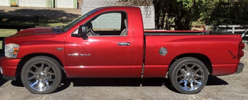

I have 16 pieces to prep, prime, paint and clear. 10 of them are the side cladding from a genuine SRT 10 truck.
Along with that, I have the hood scoop, two grilles, the front bumper cover, rear bumper and tail gate. I am trying to think this out to make sure I don't create obstacles for myself later. The rear pieces behind the wheel openings lay over the corners of the rear bumper:

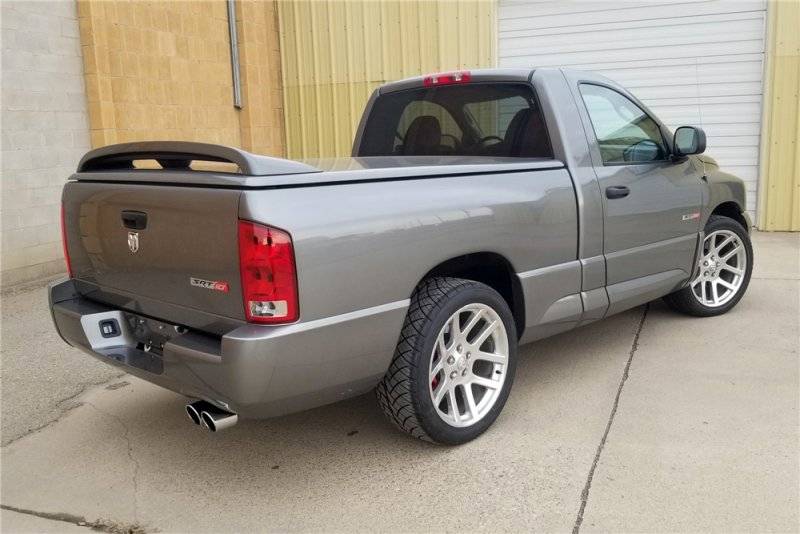

Are you putting a HEMI sport scoop on yours? also doing the SRT10 cladding.
Have you located a SRT hood and front bumper?
I could use an SRT-10 hood if I wanted. The place where I bought the cladding has 2 hoods but they want $1000 each.

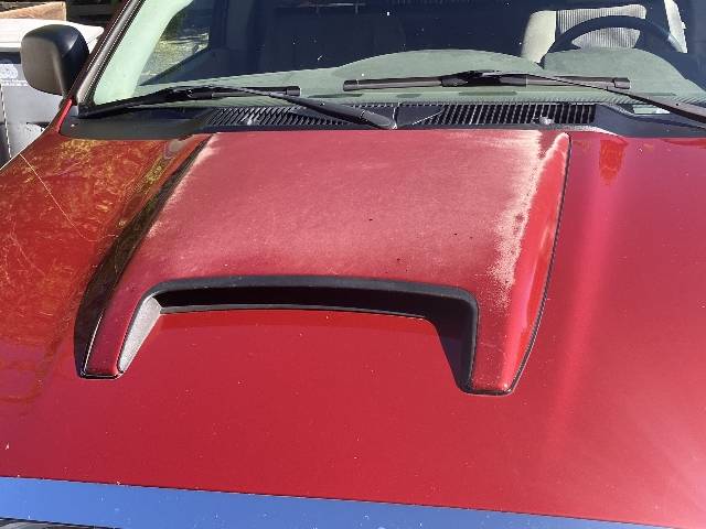

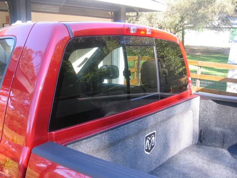

There was a scoop on the truck when I bought it new. It is a Mopar/Dodge part. This truck was dolled up with all sorts of dealer installed trinkets including a carpeted bed.
Stuff like that looked great but degraded in a few years from the type of use I put the truck through.

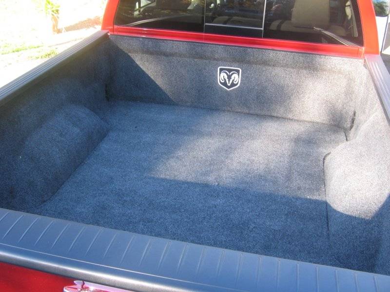

I worked construction as a Carpenter and had all sorts of tools and ladders to haul around. To add, being a gearhead, I hauled tools and parts for the many junkyard visits. Engines, axles, brakes and other dirty/greasy stuff ....
I chose this truck because even then, a 2 door, regular cab truck was getting harder to find. I don't like the 4 door trucks. I had to take what I could find. This one was already lowered, something that I was going to do anyway. That carpet kit though....
Now that I'm retired, I wish that I'd have saved that carpet kit to put back in. It really looked nice when it was fresh and new.

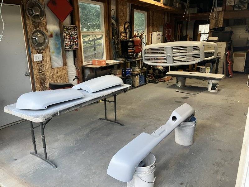

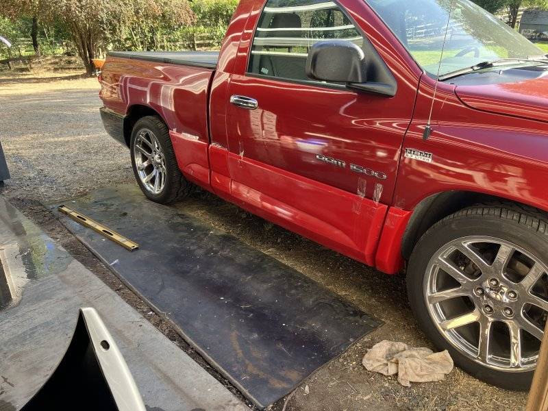

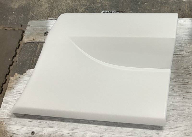

In total, there are 16 pieces that need to be prepped, primed, painted and clear coated. I sprayed most of the panels today with some high build primer reduced a bit with acetone.
Most of the panels here are clean enough, they will just need a scuff and wipe and be ready for paint.

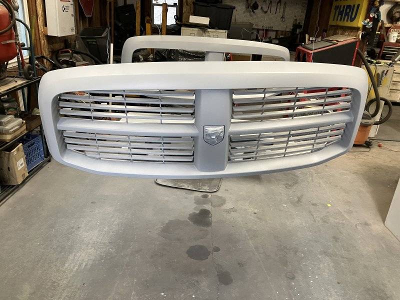

I have two grilles to paint. I wanted to have a spare but I'm also looking to try three different styles. One will be ALL Inferno Red, slats and all. The other will be Inferno Red on the outer shell with black slats. I'm then saving the satin chrome slats from the stock grille:

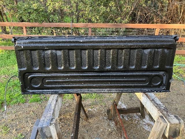

I did buy a spare tailgate. It is straighter than the one I have.
Mine has a bent flap on the lower right and a couple of scrapes.

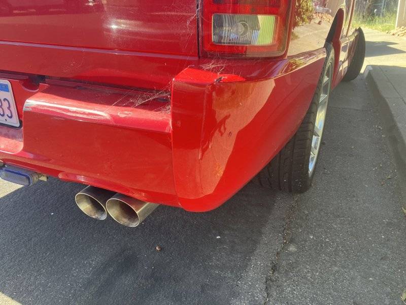

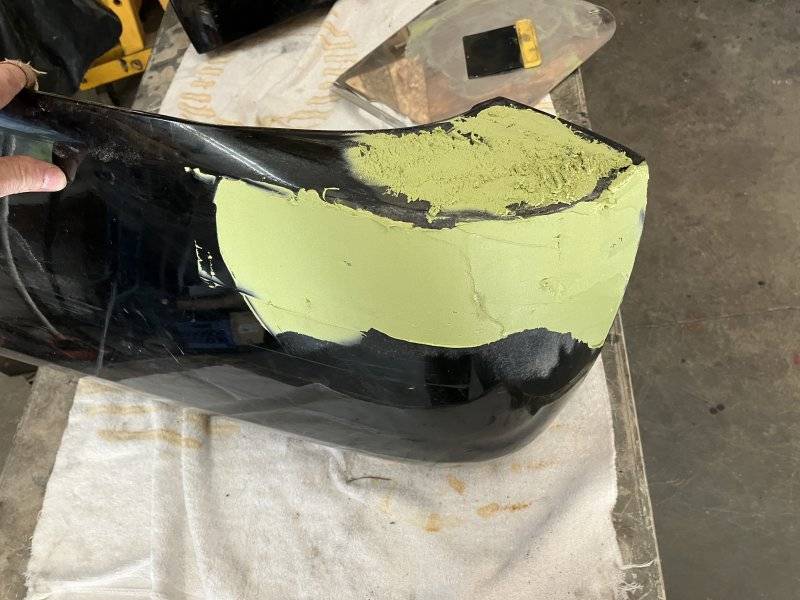

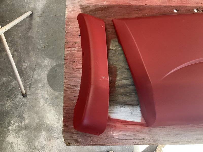

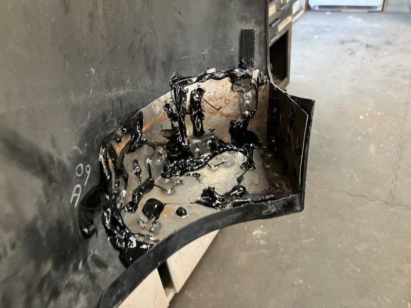

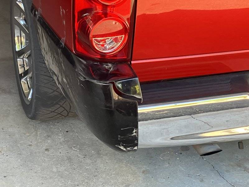

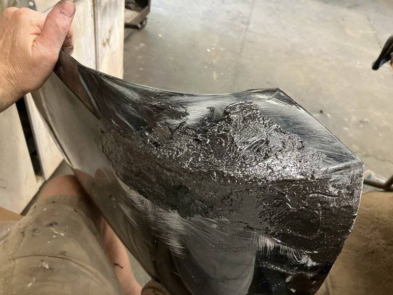

The rear corner cladding on each side needed some work, the left side was the worst as you may recall...

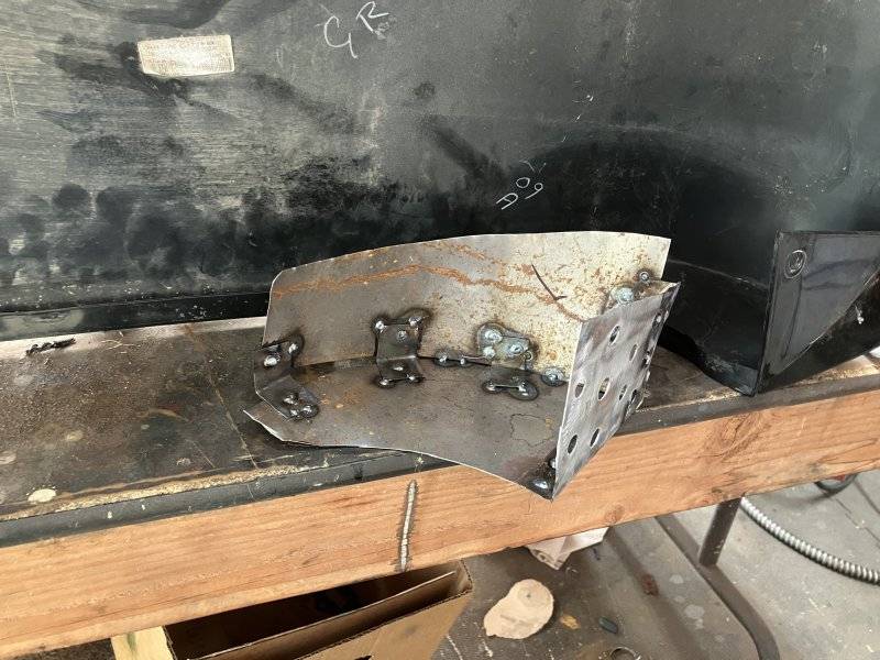

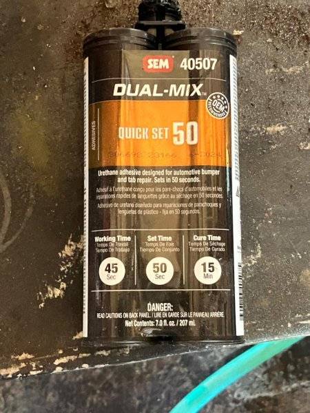

I made a cage out of 18 gauge sheet metal to hold it together while the panel bond/bumper repair epoxy set up. It will also provide rigidity in an area where it might be needed.
This stuff set up FAST.
It looks sloppy, I admit but the dang thing is stiff and strong.

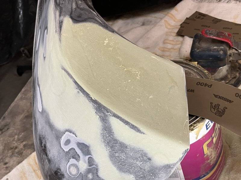

I spread some of the epoxy on the face side too. Within a short time, it was ready to sand.
Of course, nothing is perfect so out came the filler.
High build primer. This will block sand down to a smooth surface.

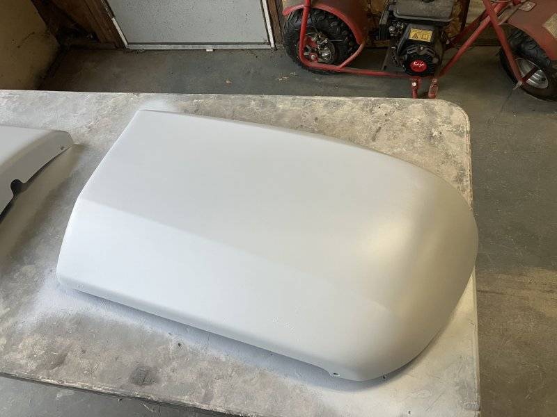

This was my first time repairing a bumper/urethane panel. It was easier than expected.
I often jump into projects with no clear plan on how to get to the end but I do know what I want it to look like when it is done.
This is no different. I figure that these panels will need 3 or 4 coats of paint to cover.
I've thought of installing the cladding then spraying the paint and clear in place. That still may happen but I might switch it up a little.
I actually could spray 2 coats of paint on everything...install the cladding....then spray 2 more coats and the clear.

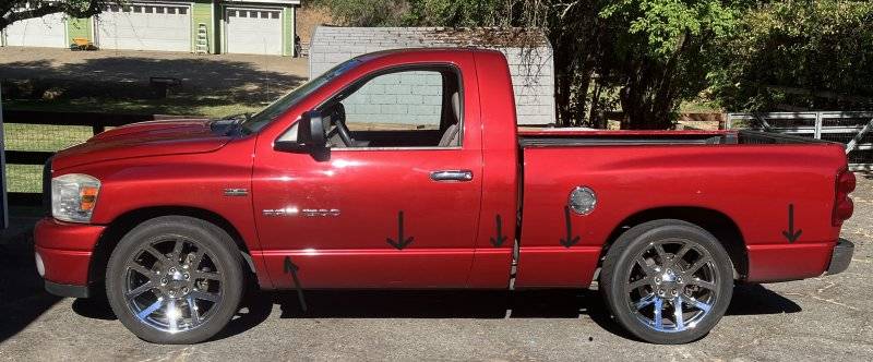

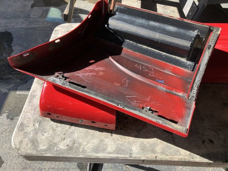

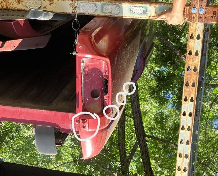

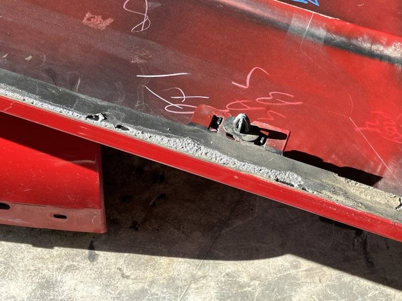

The cladding is held on in a couple of ways. There are screws in the flange in the wheel openings, two sided tape at the edges and plastic pegs.
The rear corners have additional hangers that I don't have. If the dealer cannot get them, I'll have to make something.

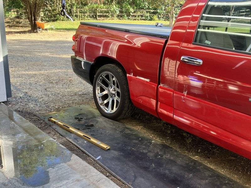

The side cladding pieces are supposed to cover this crease:
In fact, it rides up to just below the bottom of the taillight lenses.
See?
I may have to put the rearmost panels on, then the small one on the fender....then run a string line front to back to have a guideline to put masking tape for a border.

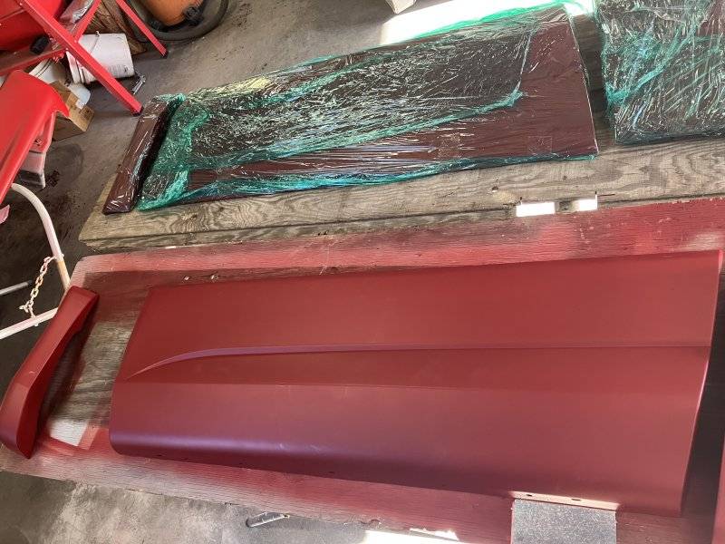

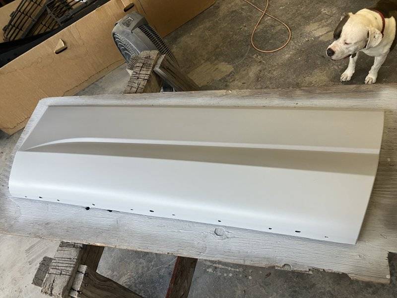

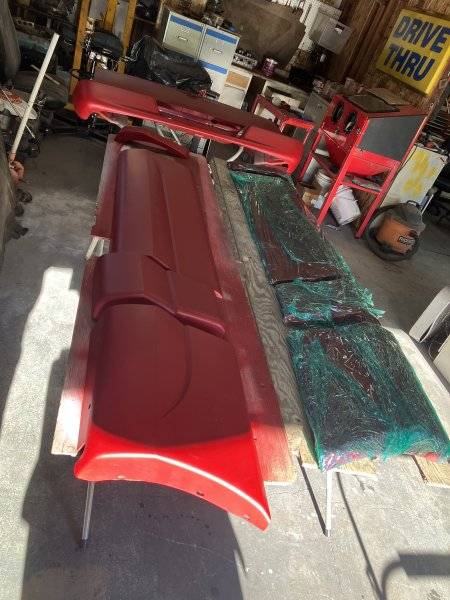

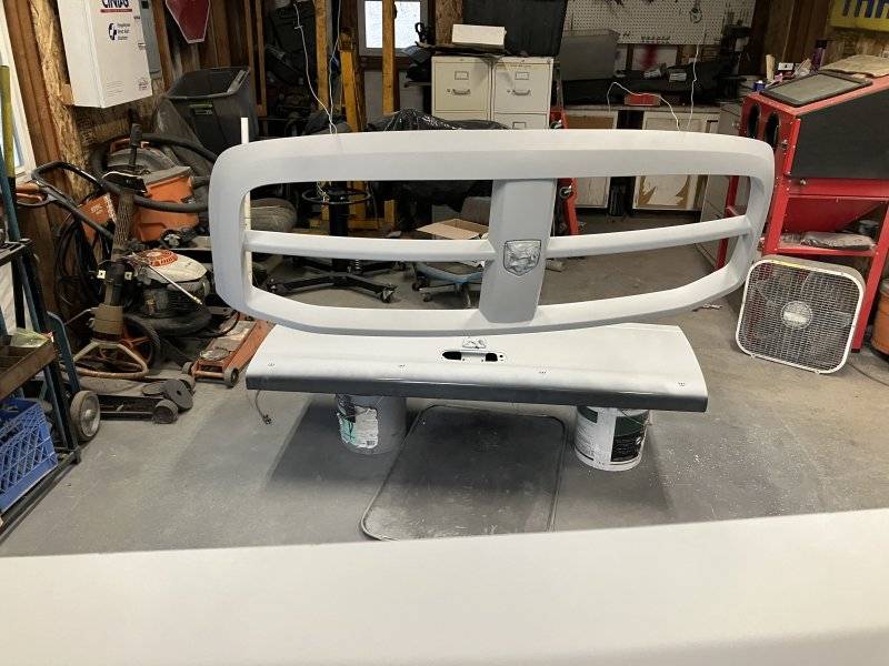

When you are ready to apply the cladding pieces permanently, wipe down the areas to be taped with alcohol. This will remove any contaminates that will cause the tape not to stick. The actual cladding parts should be done the same too in those to be taped areas. And get good tape, like 3M.
A couple months ago, I sprayed the panels with 2-3 coats of base coat, then set them aside to work on other things here.
I have been undecided on whether I should mount these and do the finish of the paint and clear with them in place or do the final paint work with them laid out on tables. This stuff takes up a lot of space.
