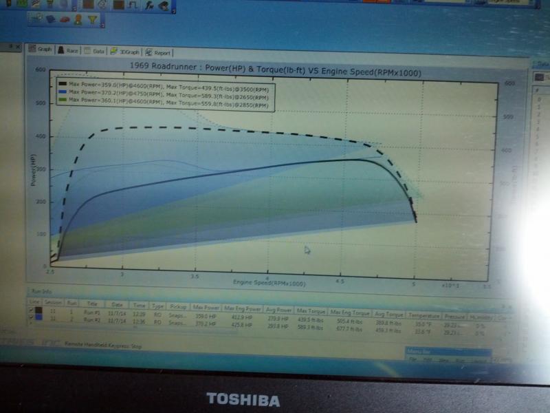

I hooked my car up to a dyno this weekend. I thought by HP numbers were going to be a bit higher but maybe this is where she should be. These numbers are not corrected for anything they are as exact as they can be to the rear wheels. I definitely have a little more tuning to do as at idle my eyes burn and you can smell fuel. My spark plugs don't look overly black or coated with soot. Engine is a 383 automatic, the last two pulls the transmission kicked down and fudged the torque numbers.

just looks like numbers from a slightly modified engine , not bad if you ask me for a street car.
I cant see it real good but if it says max power at the wheels was 360hp like I THINK it says then that is way more than just a warmed up 383 is gonna put out at the wheels i can promise you that.
i agree. thats a lot of power for a 383 auto, even with modifications.
Sorry I forgot that some are older than others :) The first run was 359HP @ 4600 and 439.5 ft lbs of torque @ 3500. The 383 is bored .030 over with KB400 pistons, CR is at 9.7:1. Cam is a comp XE275-HL, roller rockers, stealth heads, eddie Performer RPM intake, Holley 770 Street Avenger carb, Schumaker Tri-Y headers. Engine was balanced and blueprinted. I'm not sure what other specs to give, I just have fun with my car. I learned all this from books, here, and you tube.

If the heads are stock out of the box stealths you may need better springs for that cam. How did your air fuel ratio look? Cant see the graph real good on here but you can tell when the float occurs typically looking at the power graph

Your car is making great power if you are asking me Id leave it alone if you are happy with it and it runs well and performs as you want it to.
Personally I would look at the valve train after hearing your statements. Especially if you used the OTB springs on the stealths and DEFINITELY if you used the 440 source rockers both of which I have used on 3 motors now.

Again, 360 rearwheel horsepower and that torque is great for any naturally aspirated v-8 on pump gas under 400 cubes if you ask me.

i think the dyno might be a little on the happy side. with that converter and figuring at least a 20% loss, and it's probably a little more, thats 450hp or more at the crank. those real wheel torque numbers are very high for a 383. way over 500lbsft at the crank. 383's don't make torque. nevertheless, thats probably a sound street package for a 383. get some track mph numbers and do some calculating off that.

If thats accurate then I agree thats good #'s for your eng. Your looking at about 450 hp at the crank. Thats a nice running 383. Ron
Those are good power numbers! But Comp's site states that cam's range is 2000 to 5800 RPM. If the valves are indeed floating beyond 5000 RPM I'd be changing to different springs. You might just as well get all the performance you can from that camshaft.
comp recommends a 924 dual spring. the 924 isn't very stout but will allow for some extra lift. the edelbrock spring would probably work with that cam. the bad thing about those short comp cams hydraulics is the 4 degrees of advance ground into them. this takes several hundred rpm out of the engine. if it were me i'd install the cam straight up.
