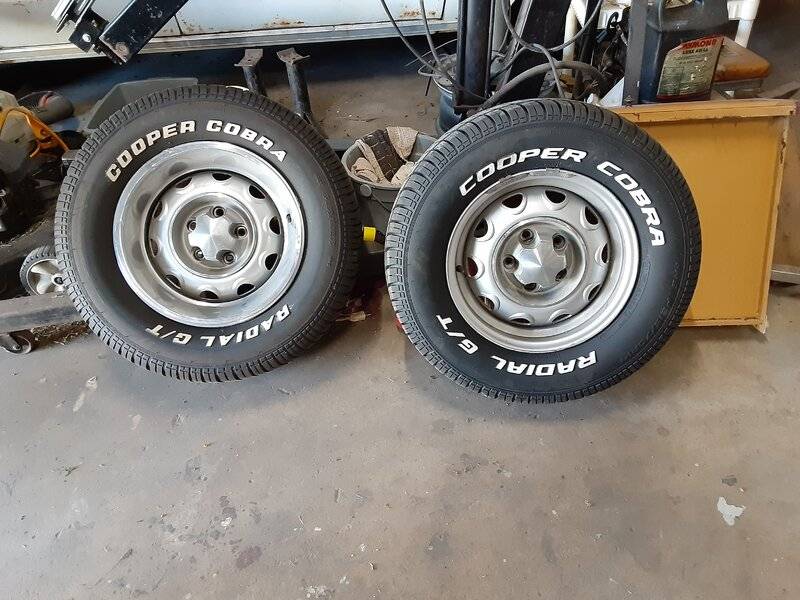

This was going to be a post about my recently acquired tire changer and balancer continuing to pay for themselves.
However.....
The old Cooper I just took off had .5 oz weight on the inside and .75 on the out side.
The new one I replaced it with took 2.75 on the inside and a whopping 4 oz on the outside!
On the same rim.
I didn't even have a 4 oz weight. I had to put 2 2 oz weights next to each other.
That's excessive.
Has anyone else experienced this?
There was no dot to indicate a heavy/light spot either.
...and to add insult to injury.
THEY CHANGED THE RWL FONT!
Really?
WTF?

Post a pic please

Why not dismount and clock the tire until the balance factor improves ?
In the last year I have bought 2 sets 4 tires each set. The older set required what I thought was excessive weight and all 4 were clocked several times with no improvement. The newer set required very little weight, in fact one only took 1/2 oz. on the inside. The other 3 in that set took 1.5 oz. or less. I haven't taken notice to where each were made. I may have to look.

I just put a set on my Lil Red Express last month. My guy said they had to clock the tires like @Kern Dog suggests to get the weight down a bit. We did static inside center only with tape weights. Looks like one of the 275/60’s took about 2oz. Rest were less.

I've had some good years that required 9oz on one side and about 5 oz in another! We re clocked many times finally after we spoke to manufacture they said it's within spec and it was fine . I told my boss to not order anymore and the guy buying was being a dick so he got what he payed for
I had considered marking the spot with black sharpie and trying that spot either next to or opposite of the valve stem.
I don't expect much change from 4 oz, though. In fact if it goes down to 3.75, that will actually be more difficult to mount weights for.
