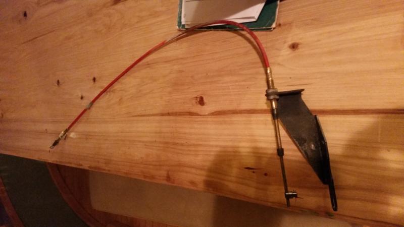

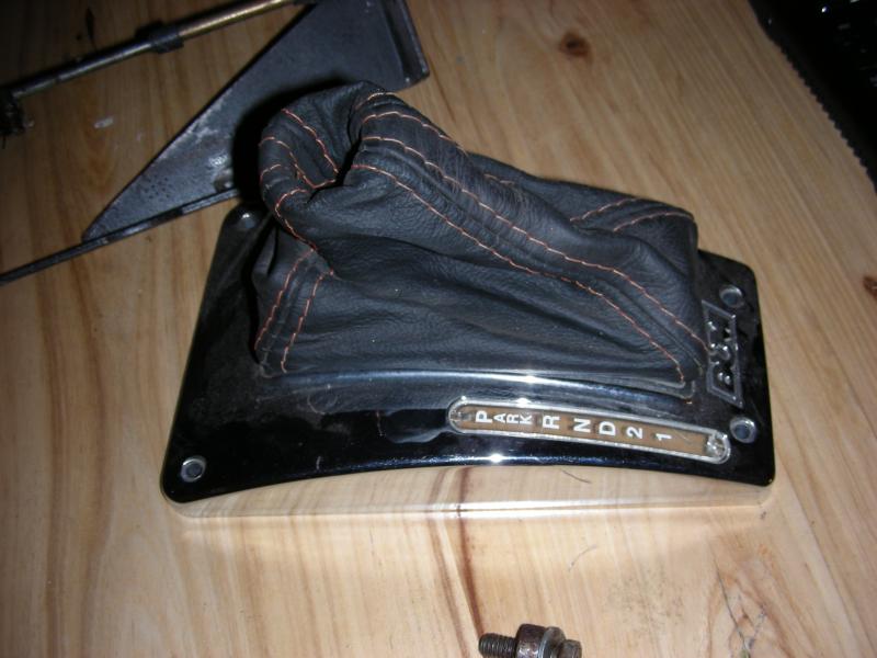

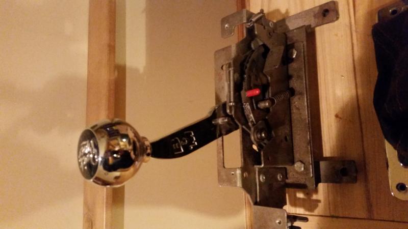

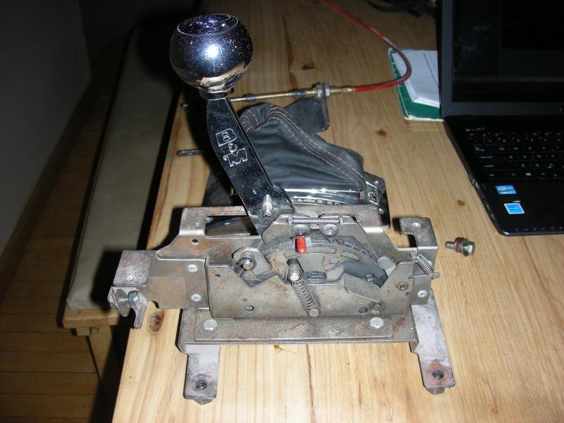

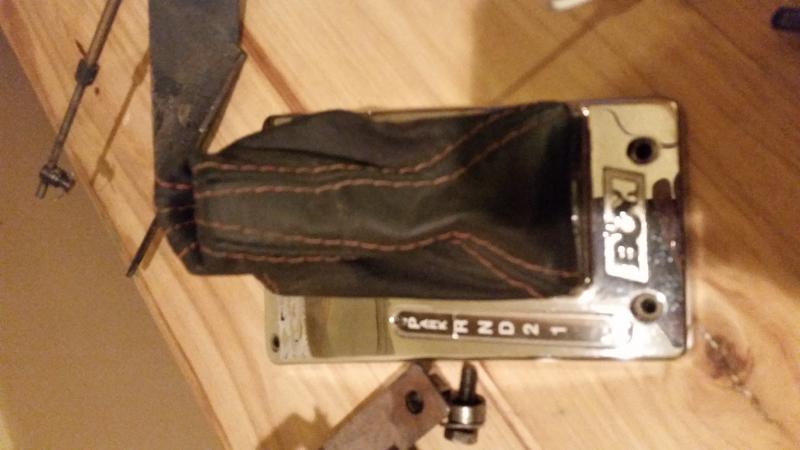

I used to have a Mr. Gasket Rachet shifter in my RR, but removed it several years ago before I started the restoration. I wouldn't mind having one again, I liked using it when street racing, and it confused a lot of people that tried to drive my car because you had to pull up the key and push down on the shifter. However, since you have to hack up the tunnel, console, and the original mounts, most likely wont do it again. I still have most of my original and see some on ebay for sale.
Cutting a hole in the tunnel was painful for sure, but I was able to get the console brackets out without damaging them sitting on the shelf. Seems they just soldered them in from the factory so the welds were real soft and just basically stuck to the tunnel floor. My console is already in need of replacement so didn't mind cutting a 1" or so out of one of the mounts. still usable lol
Here's the pics you asked.
Sorry, first attempt at loading pics with my phone.
That's better.
That's better.
