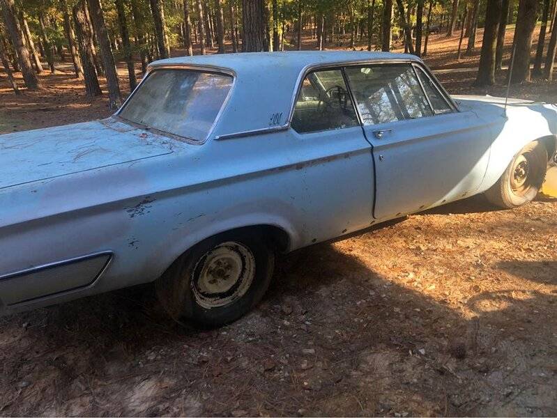

I have my eyes on a Polara. I believe its the original engine it has a 2bbl intake. I guess my question is will a 440/426 intake fit on a RB 383?
I read that the RB383 was from 1959 to 1965 I honestly don't know what is in the car at the moment. I assumed it being a 63 it would be the Rb 383. I hope I'm wrong. Maybe a 361? I'll just have to check out the pad when I go to look at the car.

All good info. My thoughts were probably a 361 But he says 383. I'm waiting for him to reply to my text. Trying to set up a time to check the car out. Looks pretty solid with minimal floor pan work. The rest of the body is in decent shape. Thanks for all the info on the RB383 I knew it was a weird engine but I guess I didn't look enough into it.

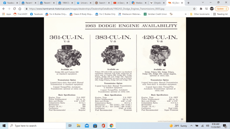

Lots of people mistake a 361 for a 383. A B383 could be had in 1963
OK good to know. I have yet to actually see the car in person but I'm kind of stoked to get something to work on. This car already has disc brakes on the front. Probably a junkyard swap but I'm cool with that.
