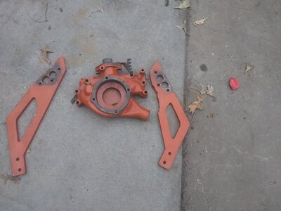

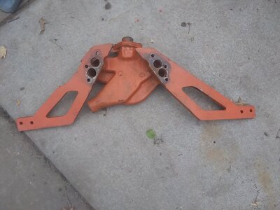

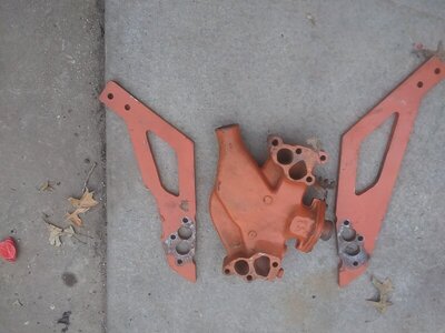

That is what's known as "elephant ears". They actually work very well, but do tend to transfer vibration. They can be modified with poly bushings to cut down the vibration.
I consider elephant ears a distinct upgrade from rubber mounts, especially in a hi performance stroker application.
I have a set of homemade elephant ears with a cutdown water pump as well
