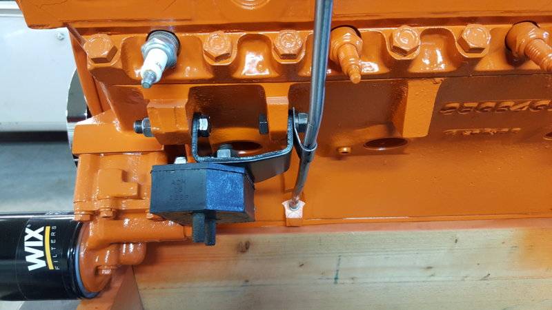

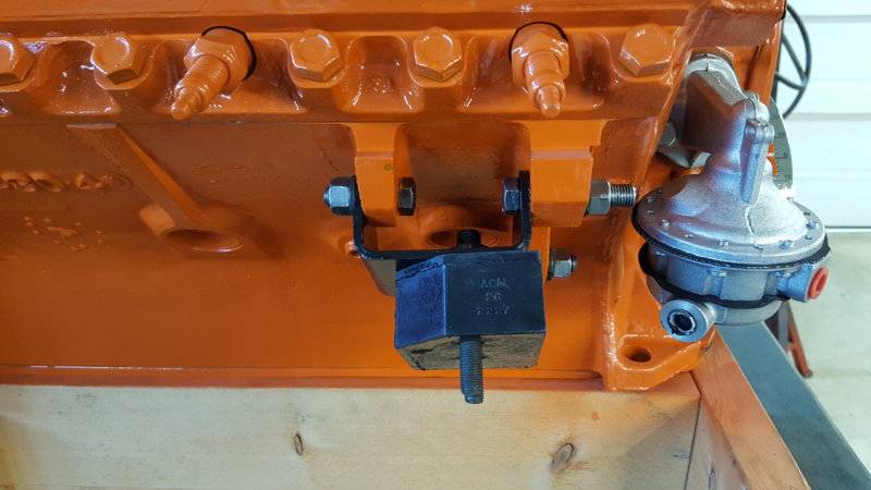

These are the rights and lefts for an early B Body. Pictures are from Kryslerkid I believe.
