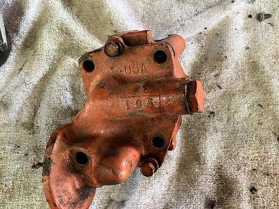

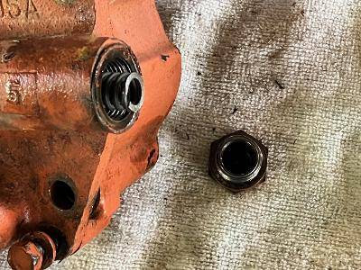

I had it in my head that I’d just spend the money and order a high volume oil pump. I’ve never paid much attention to these other than to pack them with assembly lube to prime them before a fresh fire and to dissect them after a tear down. I knew nothing of the importance of the spring inside. Seeing Nick add a thin washer between the spring and the bolt was an eye opener. Dwayne Porter suggested the spring change.

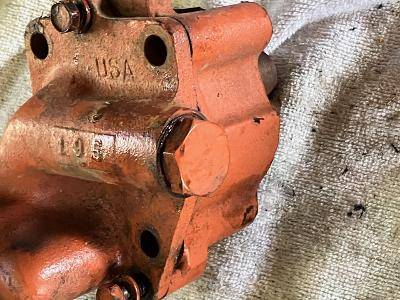

I grabbed my old HV pump from the scrap pile.
The 15/16" bolt comes off.
View attachment 1380799View attachment 1380800

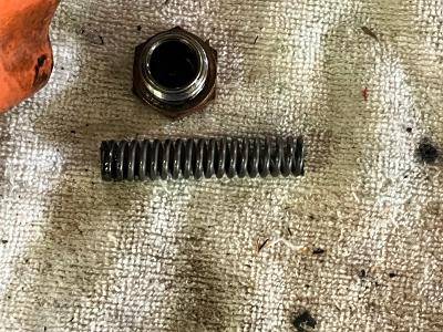

Is it really as simple as this little spring?
View attachment 1380801View attachment 1380802
Access with the pump in the car isn't bad. A Stubby 15/16" wrench fit in there. Quickie job.

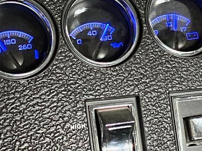

Cold fast idle....just shy of 74 PSI.

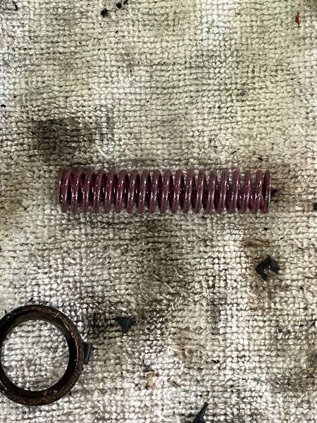

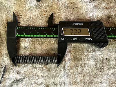

This is the spring I pulled out of the standard pump.I run the HV pump with a lower pressure red spring
OH trust me, I knocked wood (my head, mostly) whilst typing it...You know Ed, you should never make statements like that....
What exactly is/are the differences in the two springs? Stiffness? Length? Wire gauge?This is the spring I pulled out of the standard pump.
This looks purple to me.
With the different spring, The idle pressure when I am up to temperature is above 20 but not by much. It is about 35 at cruise around 1800-1900. Pressure does rise quicker. The most obvious change was cold pressure.
