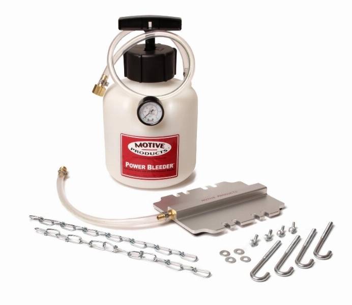

On another matter....Brake bleeding:
I don't do a huge amount of brake bleeding but when I do, I'm anxious to get it done ASAP. Sometimes I have to pull of and do other things when I don't have the help from Mary.
I am thinking of buying a Motive brand power bleeder.
Check out this video.....
There are numerous options for this Motive pressure bleeder system.
One is the universal flat plate that would work on all the stock cast iron master cylinders:
Motive Products Power Bleeder Kits 0105​
4 out of 5 stars ( 113 )
Part Number: MVP-0105
$80.96
One of the others is this type that looks like it works with the aftermarket aluminum MCs with the 2 plastic caps:
Motive Products Aftermarket Power Bleeder Cap Adapters 1113​
Part Number: MVP-1113
