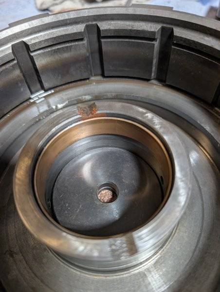

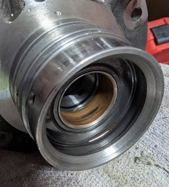

All, does the bushing look bad enough to replace? It's discolored but I don't feel any grooves. I have the bushing, but not sure how to extract the old one. Is my only option a chisel - not really a lip behind it to get a bushing driver in there.

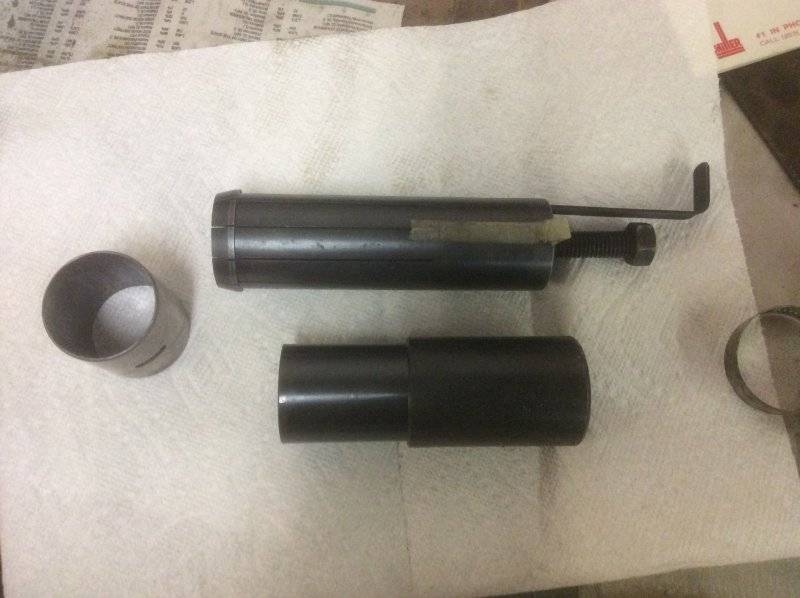

FSM should show the correct tools and procedure on replacing it. There are other ways to get them out.
Never had to replace one in 45 years of building Torqueflites. Scotchbrite it and send it.

Thanks - they suggest Tool SP-5324 and Cup Tool SP-3633. Not worth spending $60-$100 on tools I'll use once. I might go with a file/broken hacksaw blade to score it, and then collapse it a bit to the center to remove. Yes, I am considering leaving it alone..... *but* I have the bushing in the bushing kit :) .

How many transmissions have you built? I've build at least one a month for years. There is nothing the matter with that bushing. Far more important stuff to worry about. Things that you may or may not know to check.
