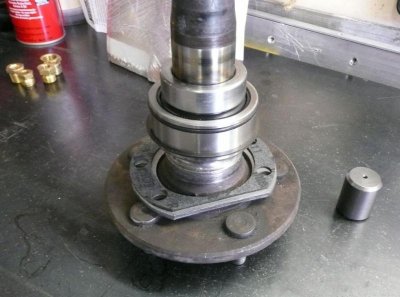

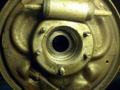

Mine is a Detroit Tru-Trac with a individual differential thrust block (shown in the picture on the right side of my axle).

This is the same as the thrust block I pulled out of my 65 Sat
