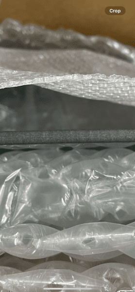

Anyone know what they make the rear glass with? Is it layered, tempered or safety? I am referring to new reproduction glass. I am trying to determine the type I have as I might want to grind about an 1/8” for more clearance in a small area. Here is a picture if that helps. If it’s tempered I know I can grind it. I don’t think windshield and rear glass would be tempered though.

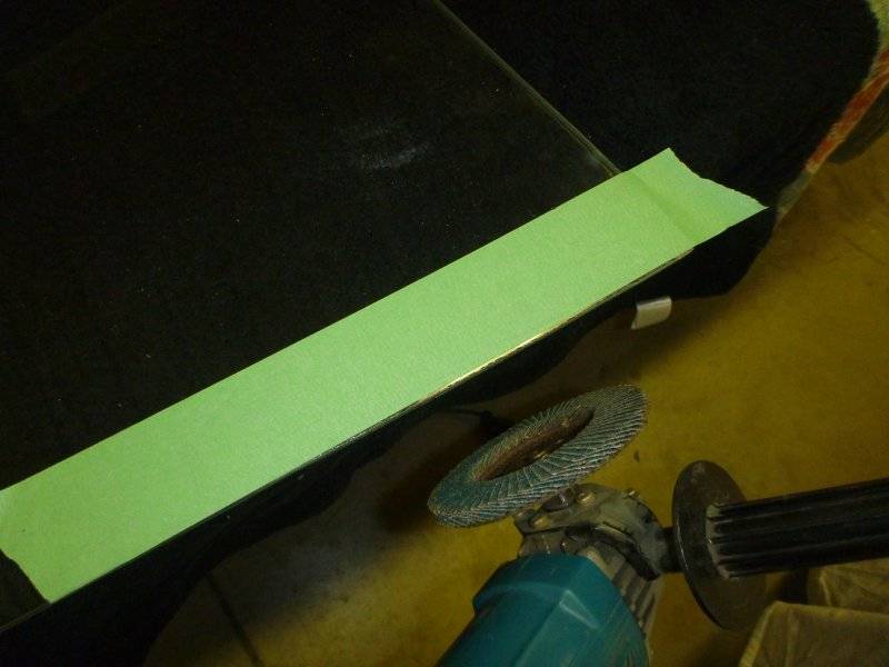

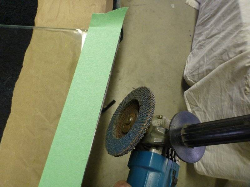

As I said, I ground my door glass down, as the slider holes were over an 1/8" too far in from the edge. Make sure that you're grinding ALONG the edge and not across it! 80 flap wheel..
View attachment 1599501View attachment 1599502
Thanks Wayne. I am wondering if messing with it after it’s been tempered will weaken it? After doing some research I am now more hesitant on messing with it.
