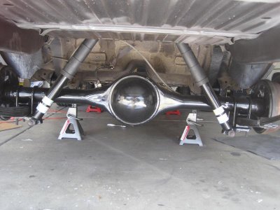

Just installed the XHD's a couple of weekends ago. Like Watermelon said, they're beefy. I painted the rear end with Rustoleum's engine gloss black while it was out of the car.
