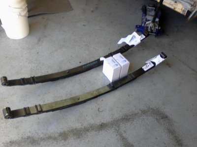

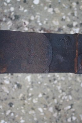

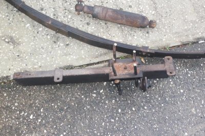

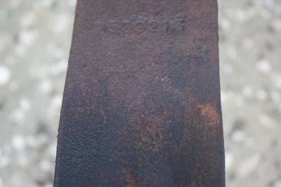

here are a few pics of the spring I removed and the new shackles and front hanger. I tried looking up the number stamped on the spring but couldn't find anything on it.
The pic I took of the misalignment of pin to spring perch didn't come out.
Is it possible that it is a dodge spring? would it be different?
IMG_8745 - 2014-04-18 at 13-59-55.jpgIMG_8743 - 2014-04-18 at 13-59-06.jpgIMG_8738 - 2014-04-18 at 13-29-06.jpgIMG_8735 - 2014-04-18 at 13-28-47.jpg
I found this about the part number on the leaf..."H.D. Rear Springs, -4 ½ Leaf STD w/ 383 4bbl WM 2539213 Std w/ Super Bee." It was referring to a 1969 model
