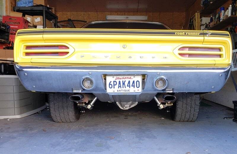

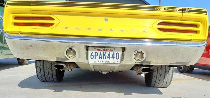

Now:
Before:
UPDATE: My Roadrunner is out of the shop and I've put some couple hundred miles on it. Various roads and speeds. The Calvert split mono leaf springs are great. Now coming from badly worn HD factory leaf springs, and a stock suspension w/Viking front shocks to USCT subframe connectors, front and rear torque boxes welded in, a complete new QA1 front suspension and K-member and triple adjustable Viking Warrior Xtreme Street rear shocks added, there's quite a bit of change.
Since I'm breaking in a new dual disc clutch I haven't been to the track, and on the street the ride is less like a worn out boxsprings bed, but I like the ride.
The Calvert split mono leaf springs raised the rear about 2" and that looks so good to me it's an unexpected bonus.
Now:
Before:

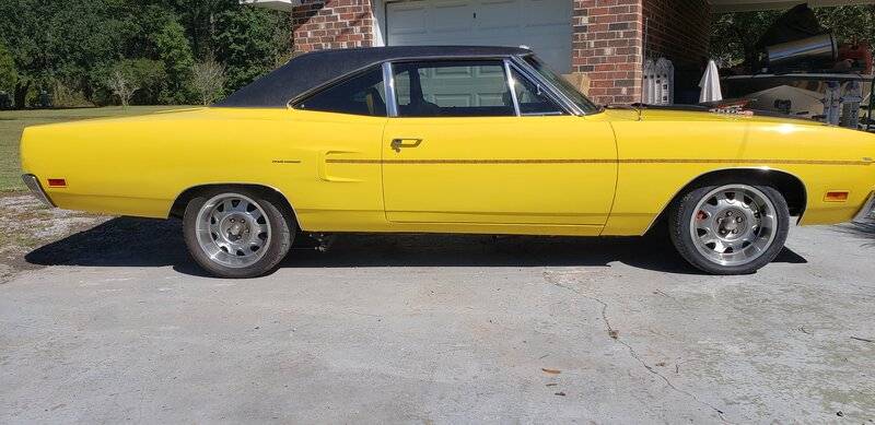

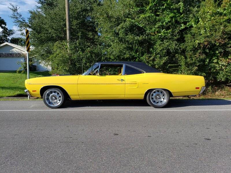

Side views: Look where the rear wheel rim falls in relation to the rear wheel opening.
Before:
After:
I like the 'before' pic better but only if the front end was lowered about an inch.....

For me, the improvement in the rear view is dramatic, was unexpected, and I couldn't be happier with it.
I think both rear and side views w/the new Calvert split mono leaf springs accentuates the outward flare of the rear fenderwells
