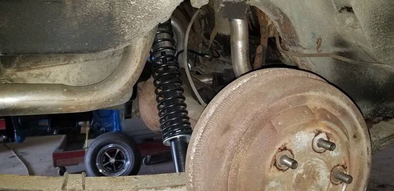

I have a ‘73 RR with stock rear suspension. I was curious to see how much the shocks change the ride height of the body so I measured ground to the same point on both sides with and without the shocks attached to axle mounts. When I took them off the body dropped about 1/2” on both sides. The shocks are some ancient something with a helper coil spring on them. I’m going to replace them but not sure what with. I do not want the ride to drop. I like the look at “stock” height. So a couple questions: Is the 1/2” drop normal, how much would you expect? Would standard replacement shocks push the body back up that 1/2”? Are the Bilsteins really the cat’s meow for a street car? What about the Monroe Load Adjusting Shocks? They look like what’s on it. I would like to firm up the handling. The factory rear sway bar is missing a link on the passenger side and the spring bushings are worn so I’m am going to replace them all at once.

They currently sell shocks with those springs on the outside, but the tension is so low that you can move the springs with your hands when on the car. So they only help when the suspension is loaded.
Sounds like you DO have the Monroe load levelers on the car now. Check for a stamped p/n in the steel tubing near the bottom of the shock. You might find the p/n's match for the Monroe's.
