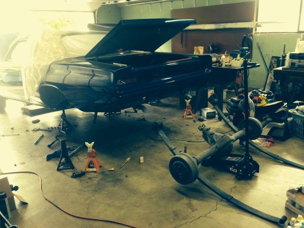

I have finished the front suspension/disk brake swap finally. Next up rear. I'm doing a true trac with 3.91 gears. I need opinions on most effective/budget friendly rear. Here's what I'm thinking so far.
1.) super stock springs
2.) 1" lowering blocks (little pro touring attitude).
3.) bilstein shocks
4.) pinion snubber
5.) possible cal tracks but that's down the road after I finish paying off the rear end rebuild.
Thanks guys. Here's my motivation pic.
