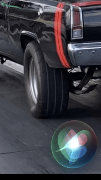

Here’s my best run from this last Saturday. You can see that it wheel hops after it’s already moving.

You clamp the front part of the spring and remove clamps from the rear. It will drive the tires into the track with anti squat. No wheel hop. Send it.
Like Frank says is one possibility. Wheel hop is either from uncontrolled spring wrap or too short of shocks; used to use longer C body shocks before started using aftermarket race shocks. Also can't have the rear axel rotating up very much with a stock type set up; need pinion snubber or race suspension mods. I've run the SS springs, race shocks and a pinion snubber on several cars with success; pretty simple.
IMO you’re gonna need to hold the differential from wheel hop. Those leafs are wrapping up and your pinion angle is going positive. I hate to suggest how to spend money but when I was where you are I went with a set of split mono leafs and cal tracs. Shocks will follow soon enough.
