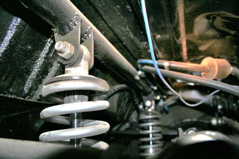

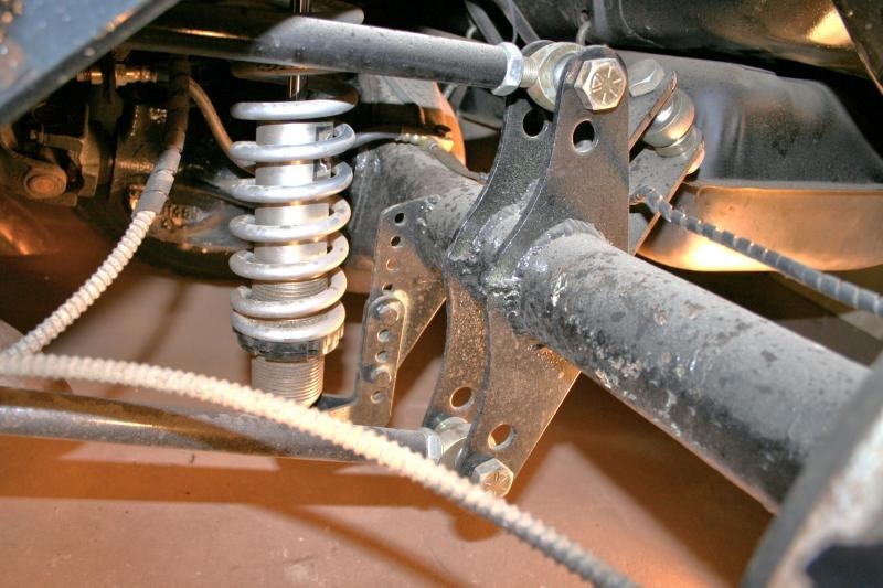

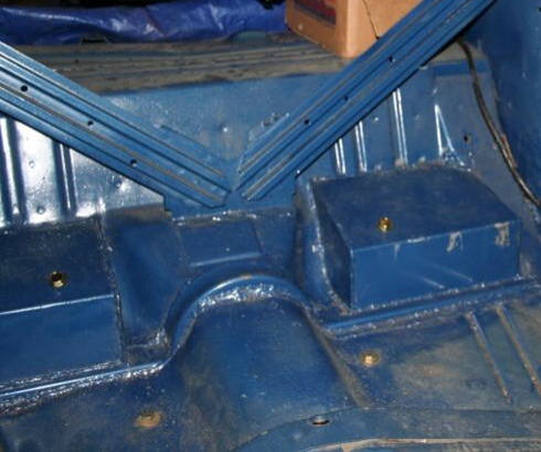

My 4 link required some boxing out of the floor. Rear seat still fits despite this and mini tub (I wouldn't have bought it without a rear seat), but it seems like it took some planning as far as length of the link bars and the height of brackets so the rear seat would fit.
Also, putting real power to the ground, I'm sure plenty would argue that the whole setup needs to be supported with a roll cage supporting the bracket area, driveshaft loop and the shock mounts.
