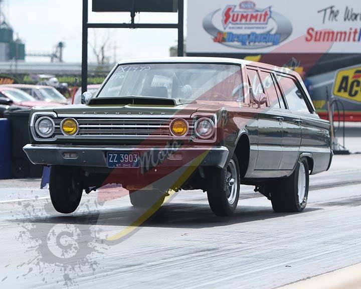

I have the Caltrac mono-leaf. 9 way shock in the rear set on #5. 318 torsion bars. 9/10’s. Mild 440 3000 stall. 3.73’s with Detroit Locker. 3400 empty. 275/60/15 Cooper Cobra’s. As long as I don’t open the secondaries in the first 10 or 15 feet it hooks pretty well. If it starts to spin it will boil the tires all the way to the 2/3 shift. I will need some DR’s to race. I’m guessing a 2.10 or worse 60 time right now if the track is prepared. Shady side showed himself cooking a large batch of goo. Brakes are fixed so I guess it’s time to run it.
