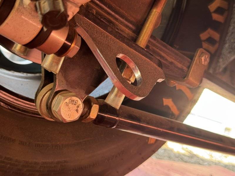

Do not. I have shocks front and back, mono split with the drag race Caltracs setup. To be honest, I don’t think I’ll ever NOT buy Caltracs. They are the best money you can put on the car. Dad’s old Dart was the same way. I also went with their tie down strap bracket. Highly recommend it.

We ran a 600hp 69 Dart Swinger with the drag setup and it was the best money we spent on the car. The car was overpowered and would hop off the line. We tried a lot before putting The Caltracs setup on and it was a total game changer. It’s what influenced the Charger purchase. I would buy it, no hesitation and reep the benefits.
