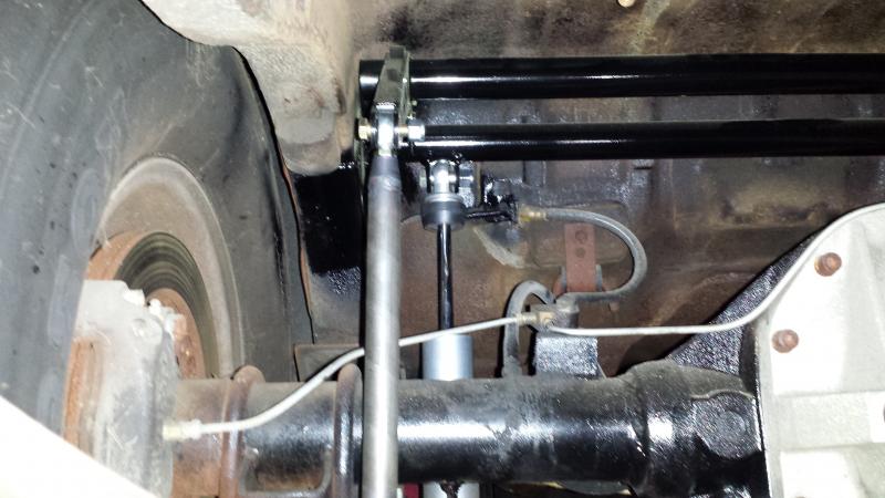

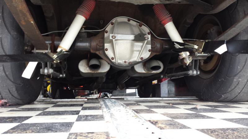

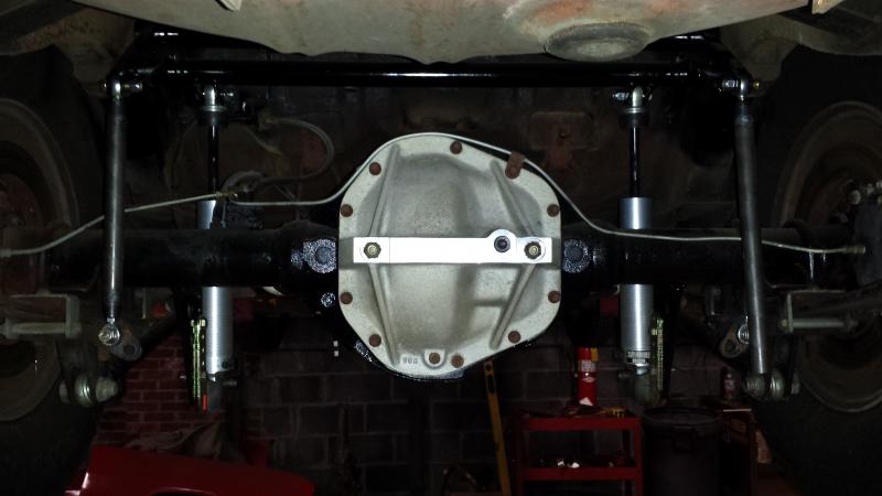

Basically I relocated the shocks forward of the rear added an Art anti rollbar and replace the rear shackles with sliders the shocks are strange double adjustableimage.jpgimage.jpgimage.jpg

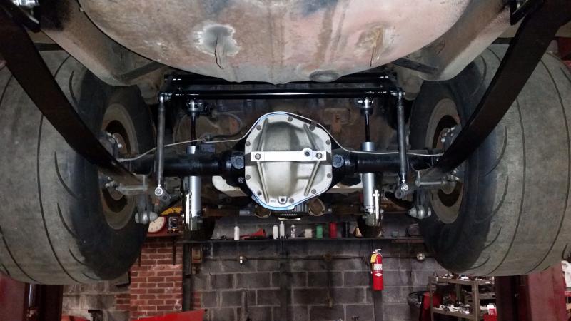

A before and after shot
Any thought on a 4 link with a slider on the frame and leaf springs? Could not figure out how to take care of the horizontal movement until I seen the slider.
:iamwithstupid:That does look interesting. But, how does it perform? Do you have any before an after data?

I haven't gotten the chance to try it this season but the design concept is sound I was influenced by Guppy (Adam Saylor) green demon as anyone can atest that Demon is bad *** as a matter of fact I bought my strange double adjustables from him I believe he upgraded to Santhuff shocks the only difference between our setup is he has a fab9 rear diff I have a Dana60 Also Adam is always willing to share his knowledge and help others out including me.

It looks like a 4-link would benefit from the anti roll bar but if I went with the ladder bar setup, nothing would be gained.

with the ladder bar you wouldn't need an anti rollbar. on a leaf spring car especially with the split mono leaf I consider it a must have to keep the axle from winding up if you already have the caltrac setup you might want to this setup cost is minimum plus you can run some stock suspension class that might be available at a local event
