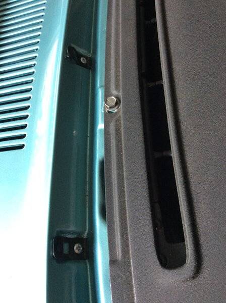

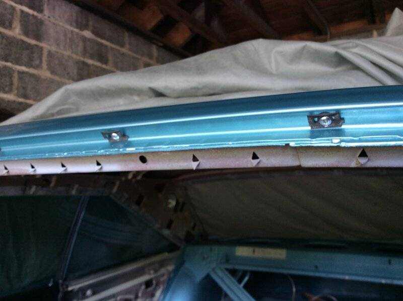

I'm guessing by your icon it's a '69. While I'm not familiar with that model year I can tell you that on the '66 and '67 all the rear glass clips are the same. However, on the front glass the larger clips are for the bottom and the smaller clips go up the A pillar and across the roof.

View attachment 1225933 View attachment 1225934
