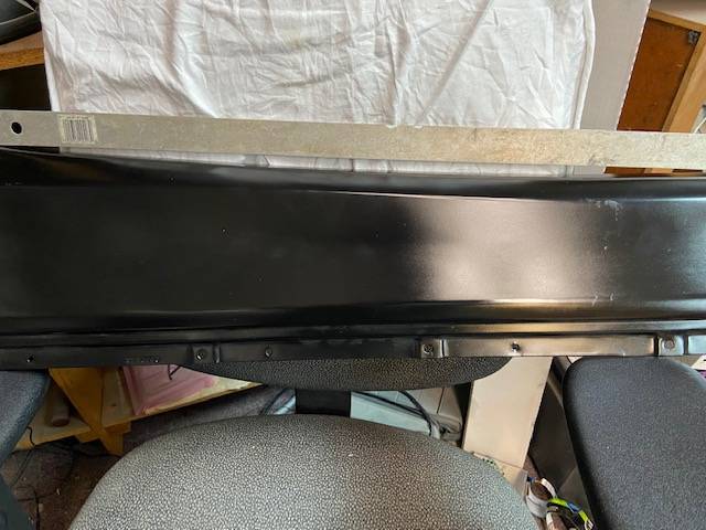

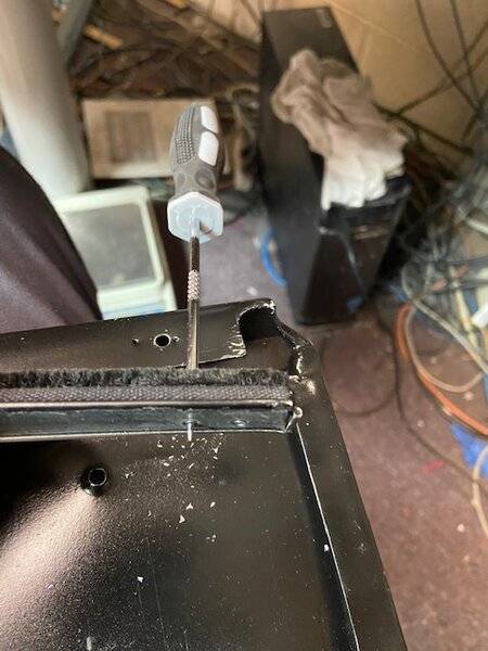

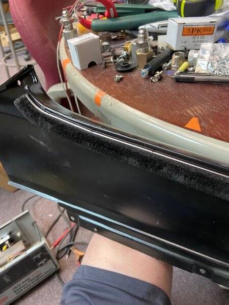

My 1968 Roadrunner is a hardtop car (no post). The rear inside window top metal trim panels (where you attach the fuzzies) have a slight curve to them with a larger curve at the back.
I have a fuzzy set with the rear larger upward curve, but the rest of the fuzzy is straight. Does anyone know if someone makes a set of of the slightly curved fuzzies? The small metal plate the fuzzy is made on will not bend. Do I notch the metal backing fuzzy plate to try to bow (bend) the fuzzy to match the inside seal trim plate? Anyone else had this issue?

I have a hardtop (no Post). The metal inside frames are the ones that came on the car. my wife is the only owner of the car. i have the fuzzies for the inside that has the radius on the ends just as you describe. They sort of match the radius on the metal panel, BUT the inside metal frames are not straight from the door opening back to the radius. it is slightly radiused or arched.

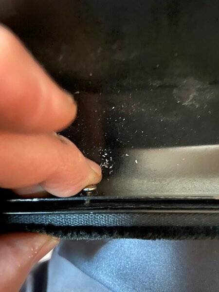

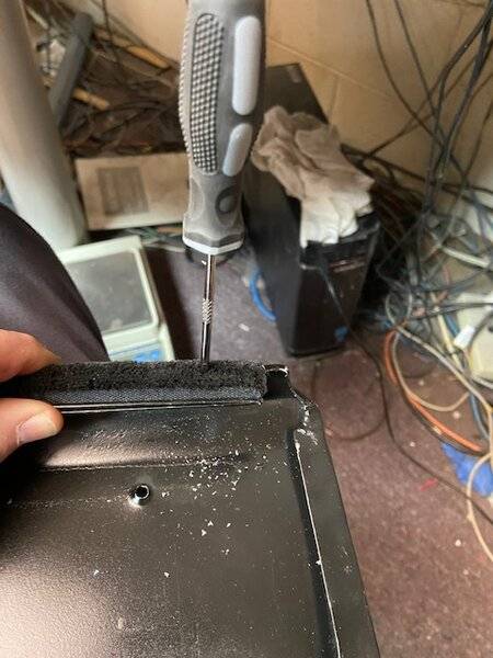

Yes, will take a pic at lunch and post. i think this will explain better.
PT

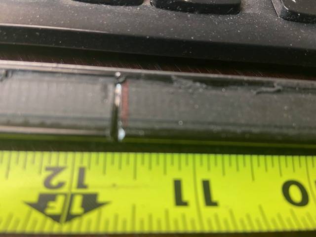

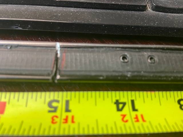

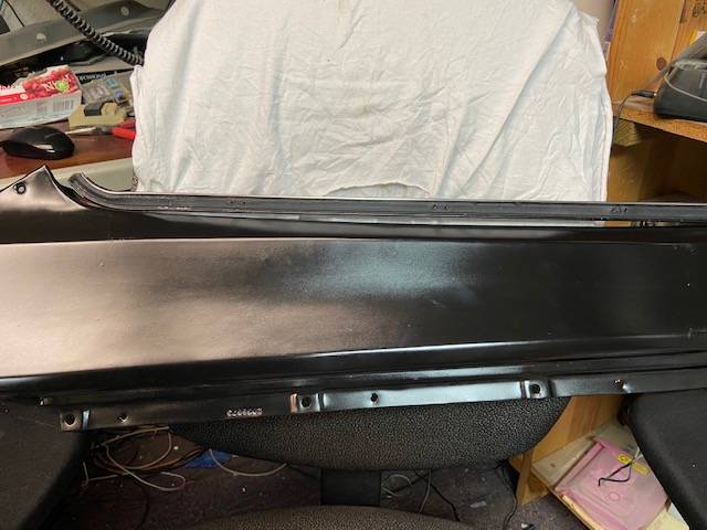

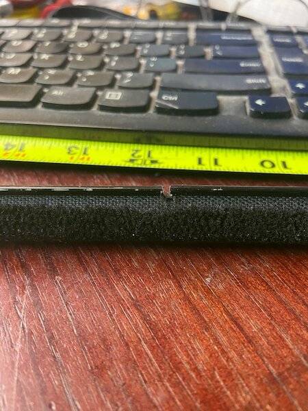

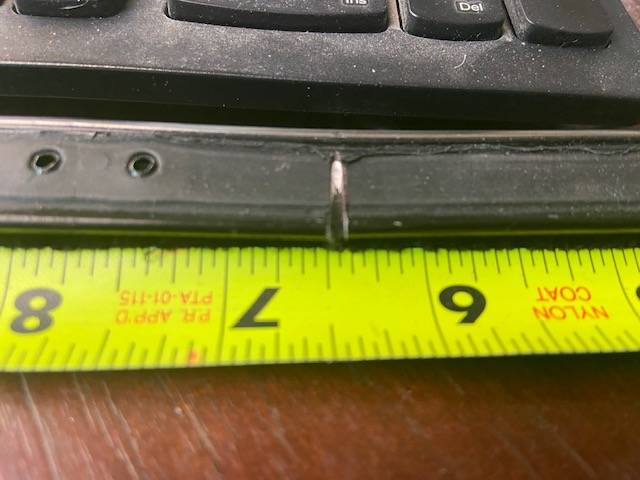

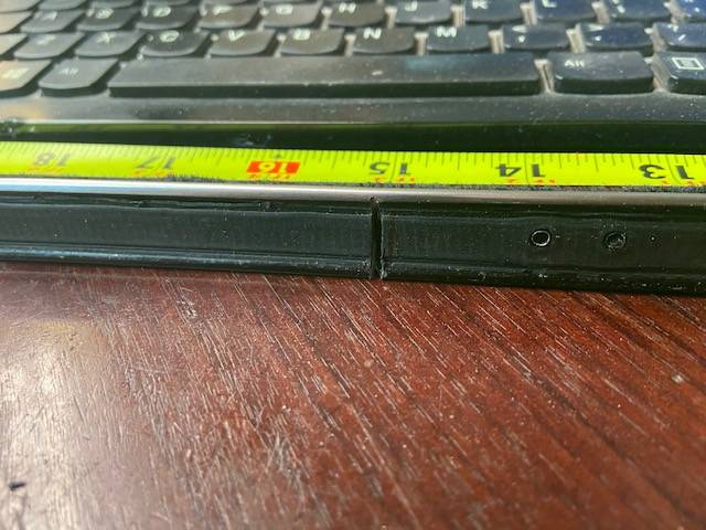

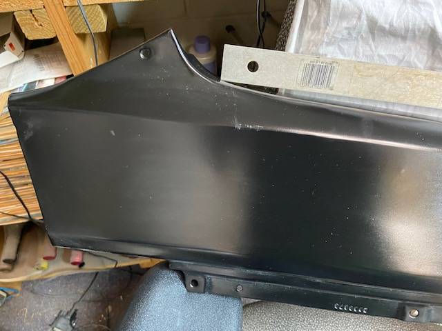

Sorry for the late reply. i am posting 4 pics for clarification.
Pic 1 shows straight edge to clarify radius of door panel
Pic 2 shows curved back portion with straight edge
Pic 3 shows straight fuzzy being held and radius under it
Pic 4 another one for clarity
Is there a fuzzy that is curved to match the panel? can this fuzzy be notched to match the panel?
Please help
PT in Tennessee

The inner felts for the 68-70 B-Bodies were attached at the factory with basically a heavy staple that penetrates both the felt and the metal panel. The Dodge B-Body quarter glass felts are slightly longer than the Plymouth B-Body felts due to the differences in wheelbase. Doors are the same.
So I am assuming that your only having an issue with the inner felts for the quarter glass. The slight difference in the arch for the length of the felt can be achieved with the installation of the felt to the panel. The "upkick" at the back looks proportionately correct to the panel.

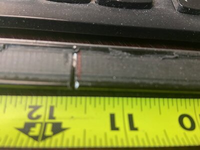

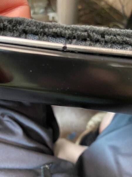

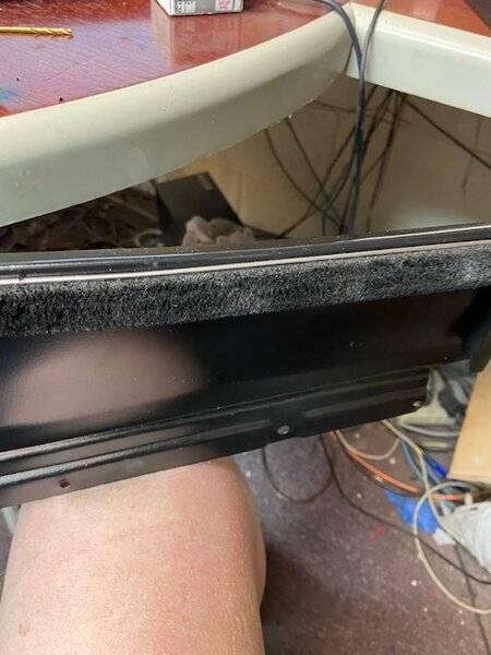

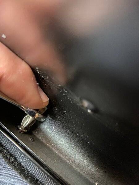

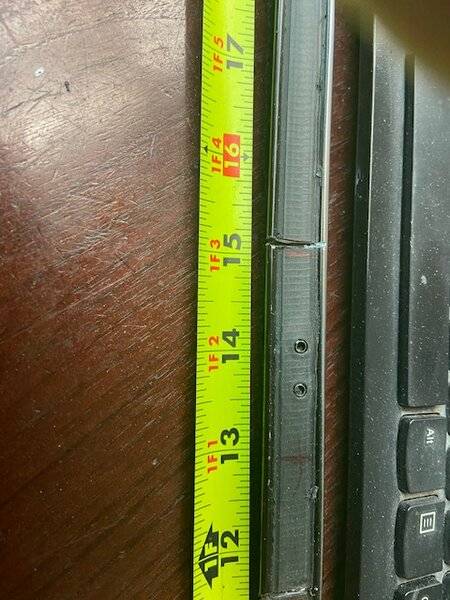

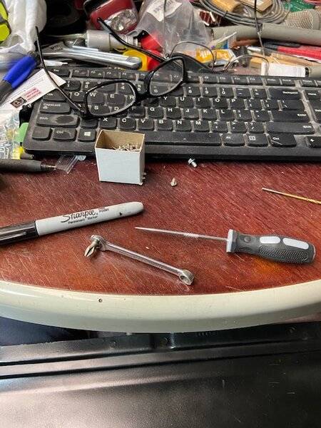

Here are pics of what i did. mounting one end with screw and home made tool, some holes were already in the metal backing plate but had to add one on the curved up end. stuck awl through the fuzzy side and holding the fuzzy-scratched a mark on the door top trim piece. center punch and drill holes in the door plate slightly oversized (for known error created in the marking). i had to put partially together several time to check marking and drilling. holes drilled in the fuzzy plate were drilled a smaller size to told the sheet metal screw. i screwed up one hole and had to use a #6 screw. will pit a small bead of black silicone on the underneath size just to try to seal a little more where the fuzzy plate does not fit perfectly against the door trim piece. Maybe this helps folks a little. Still have not figured out how to use the staples!
PT in Tennessee
